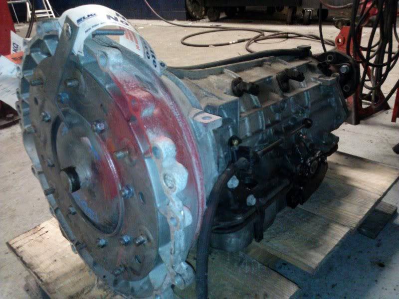

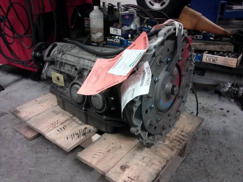

oh no, if it was just out of spec you would have got reverse back after a battery disconnect, break-in procedure or not. sounds like you have a good deal on a newer trans tho
Damn, I still think you've got one of the slickest first gens out there! Hope the new tranny gets everything running smoothly again (im sure it will).

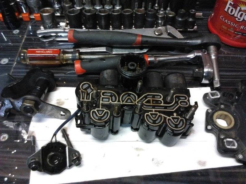

The problems with this 5R55S trans sounds very similar to what you're describing. I just started the rebuild of my 5R55N yesterday, it was driving, shifting fine until one morning it just wouldn't move. I'll post pics in a new thread as I go. I wouldn't be afraid to go with a used trans just make sure you get some kind of warranty. Or you could do the rebuild yourself, looks easy enough right?? Lol
You could swap the solenoid, filter and servos yourself for around $600. I doubt it's a fun project though.
The solenoid pack is relatively easy to replace once the pan is off, the valve body stays in place and the gasket is reusable. I haven't gotten to the servos yet so I'll let you know today when I finish my teardown.
In the pics is the solenoid pack removed with the gasket and it's located in the bottom right of the trans. The hole in the case is where the connecter goes through and plugs into the harness. Mine is a 5R55N from an 02

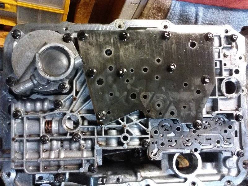

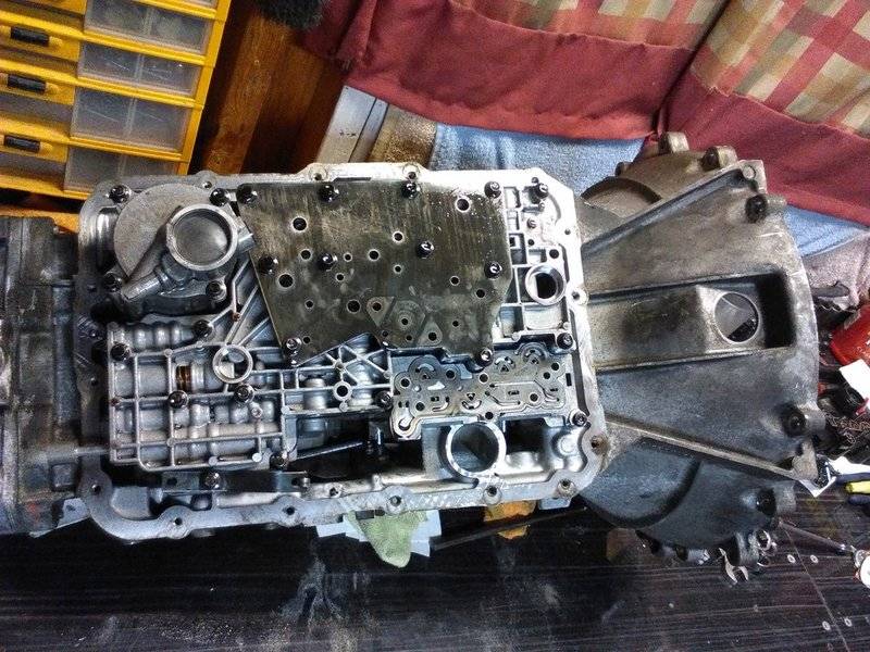

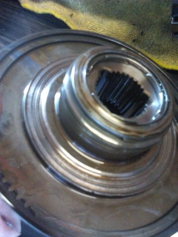

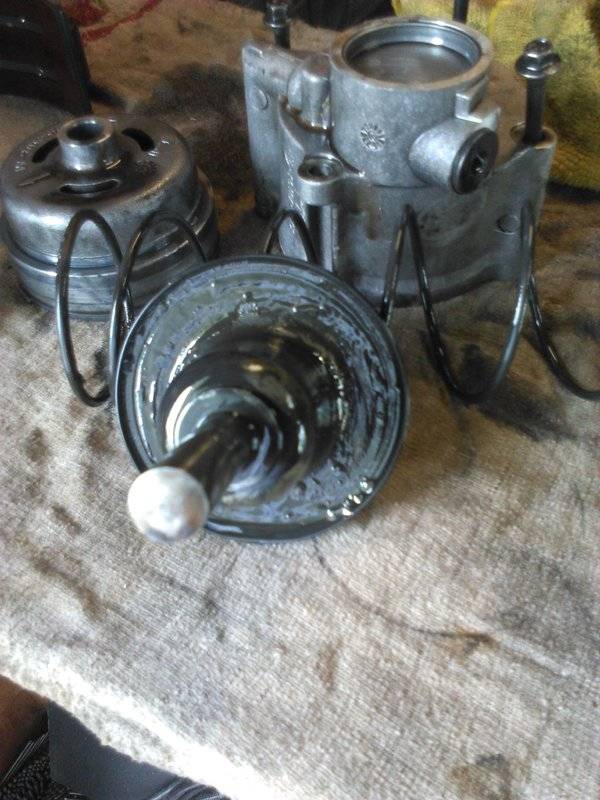

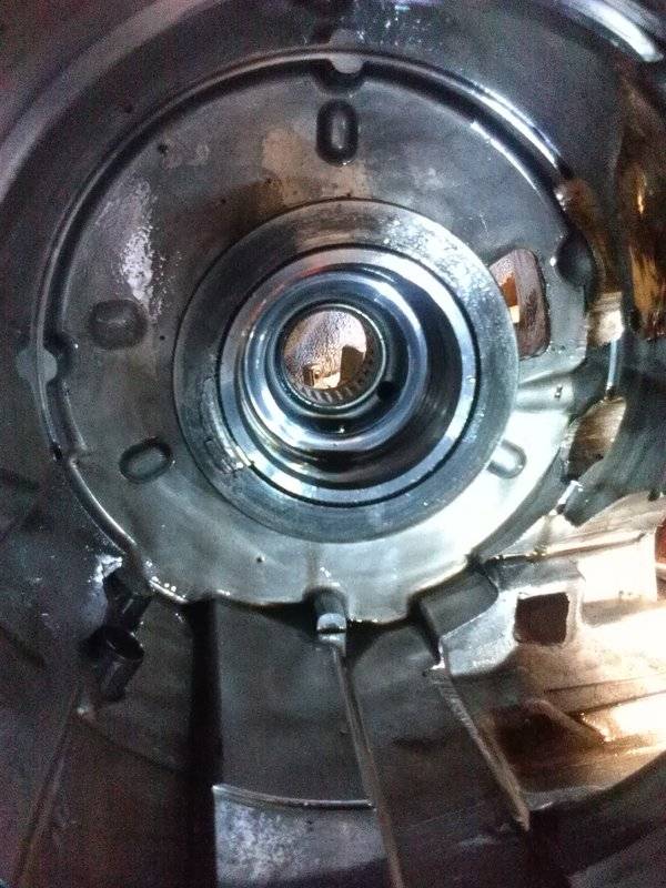

I was finally able to sign into my regular account and I finished my teardown. All of the forward bands and drums looked pretty good, nothing other than normal wear. Got to the rear of the case where 5th and reverse are and the reverse band and drum are smoked, and the reverse planet has been eating itself up on the bearring in the rear of the case. That bearring is stuck to the case and will be a bitch to get off. The servo is also full of garbage as you see in the pics.
I will take the case to a trans shop for cleaning and drilling out the servo bores and installing bushings. A special jig is used to keep the holes straight in the case. Now the hard part is identifying the right hard parts and getting a master kit. I might throw a used one in just so I can have the car back and take my time with this trans
