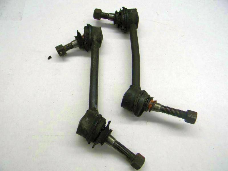

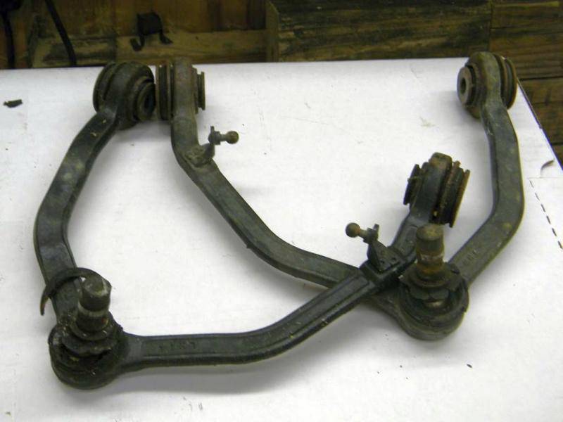

If you UCA's or sway bar end link's look like these.....replace them! I'm more of an (suspension expert) and not so much on the engine as I've not had any engine problems YET!
mine looked like that. made a hell of a racket.
My sway bar end links rattled (wasn't a clunk tho) all the time....drove me nuts but the new ones looked nothing like these, the new ones had bigger connecting rod, bigger ball joints and were bent almost like an "S".
yeah the Moog ones are bent. i used TRW ones, they were straight like the ones i took out.
