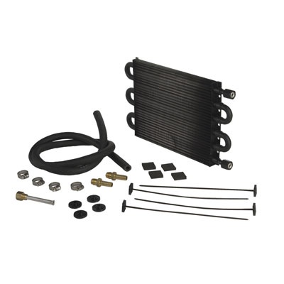

So a standard tube and fin of maybe a 24k gvw cooler I guess. Like one from trans cool or some crap like that?
Like this?

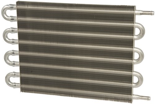

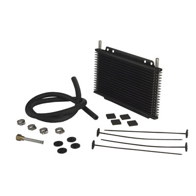

you want a "stacked plate" cooler.
not a "finned tube" cooler.
the stacked plate is more efficient.
run it after the cooler in the radiator, so attach it through the top rad cooler line.
and it shouldn't be an issue.
you should get a 40k if you run a stall converter, but a 24k cooler is probably alright for a stock trans. i think that's the size i have.
