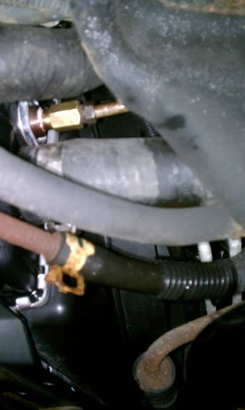

Over the weekend I finally got around to replacing my leaky original radiator (had a slow coolant leak from the plastic tank). Well 2 days later I noticed a spot under my car so I peaked under hoping it was just some residual coolant still dripping from the core support or something..but no turns out now my trans fluid is leaking from the fitting that screws into other fitting that is pressed into the plastic tank.

I have bad luck with this sh*t because on my old 97 thunderbird I went through 3 radiators, the original which I replaced when I bought it, the 2nd radiator which eventually started leaking coolant 2 years later and the 3rd, all of which leaked trans fluid from the fitting. I don't know if it is the sh*t quality radiator that the part stores around me sell or the fittings that they supply or what.
I used the new brass plated fittings that came with the radiator, and I compared them to the original ones from the old radiator which were identical in size, I used pipe thread sealant on them and STILL the f*cker leaks. I got under and tightened them today on the off chance they somehow loosened..and no change BOTH fittings leak..and of course I didn't save the old ones off the original radiator which went out to the garbage 2 days ago.

You might want to try teflon tape if paste did not do trick. Also I hope you loosened the steel tube nut after the brass fitting that is leaking when you tried to tighten stuff up again. If not, nothing will move and "seem" tight.
Yeah I put a crescent wrench on the fitting and the nut and tightened both, so they are both for sure tight, but this weekend when I have a day off I'm going to remove the trans lines again clean the threads and dry them and try the teflon tape this time, and if that doesn't work still then it has to be the fitting going into the radiator that's the culprit..and if that's the case then I'm just going with a stand alone trans cooler..soo ill give it one more shot.
From your reply I still take that you never tightened it really. You have to loosen the tube nut BEFORE you tighten the brass piece again. Tighten brass piece then tighten up the steel tube nut that was not showing any sign of leaking. I also have a huge 40K trans cooler in my car but also have a 9.5 inch converter.
NOTE I have to check to see if the tube nut is a flare type or is there "o" rings in fitting so it can spin on line when its tightened. If its flare it locks the tube/nut and brass fitting together. If its o ring type then your way is cool.
No I know what you're saying, I just explained it wrong, I had a wrench on both the nut and the fitting, I held the nut on the trans line in place with the one wrench and tightened the fitting with the other and watched the fitting tighten into the radiator (by doing so I really loostened the nut going into the fitting) so then I did the opposite and held the fitting in place and then tightened the nut that is on the trans line...that way both are tight
