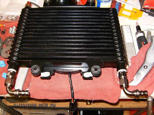

Tru-Cool 40,000 GVW - stand alone
I used a B&M 70297 with a built-in fan. Doesn't come with any hoses, fittings, or mounting hardware, though. You have to figure that out on your own.

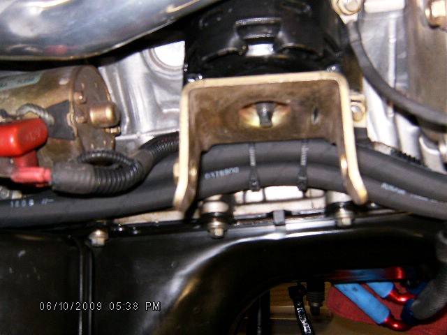

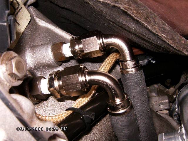

I put the same one driller has on my car, but put it in front of the condensor. I used Parker push-lok hose and fittings.
