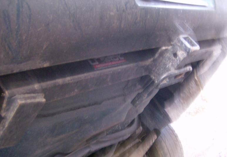

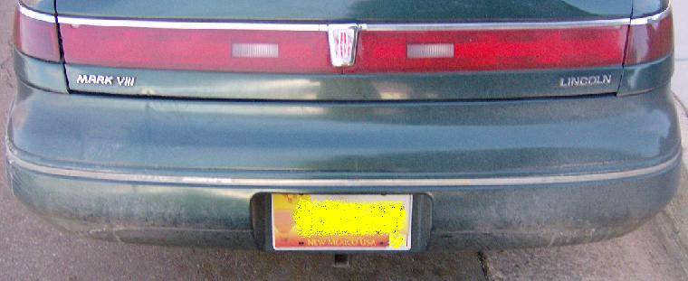

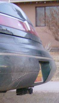

I've towed a little more than the recommended weight with my Mark.. I have whatever class 2 hitch Uhaul offers, if you go that route pay for them to install it... It's not too noticeable, I can get a pic when it's daylight tomorrow if you want.

Without the ball on, it wasn't noticeable. I've taken to leaving the hitch on, I got sick of blue-hairs bumping my car in parking lots. Now- they hit the hitch.

Pics would be great... How much did the reciever and all that weigh?
All I remember was I really wanted to not drop it on my face during the install.. If I had to guess 25 or so lbs for the receiver. I dunno. I'll get a pic tomorrow.
25lbs for the receiver? :lol:
My bumper hitch alone on my diesel weighs more than 25lbs.
Hey it's only a class 2 hitch. Might be more than 25 might be less, but this is no Duramax 1 ton you know.
Anyway please excuse all the dirt on my car, just got back from a drive where the road was all wet, it'll get washed later tonight.
