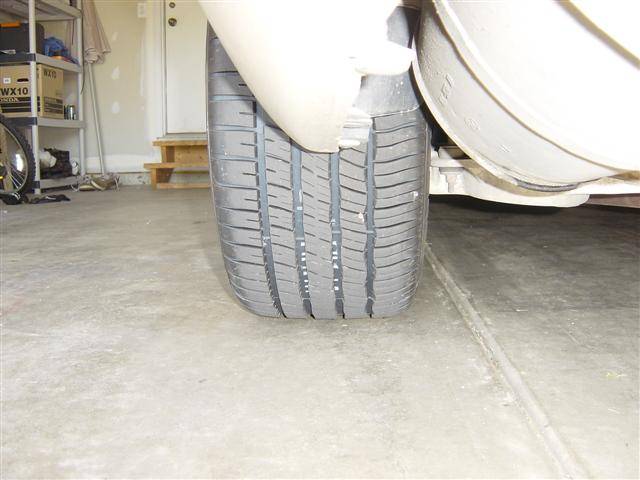

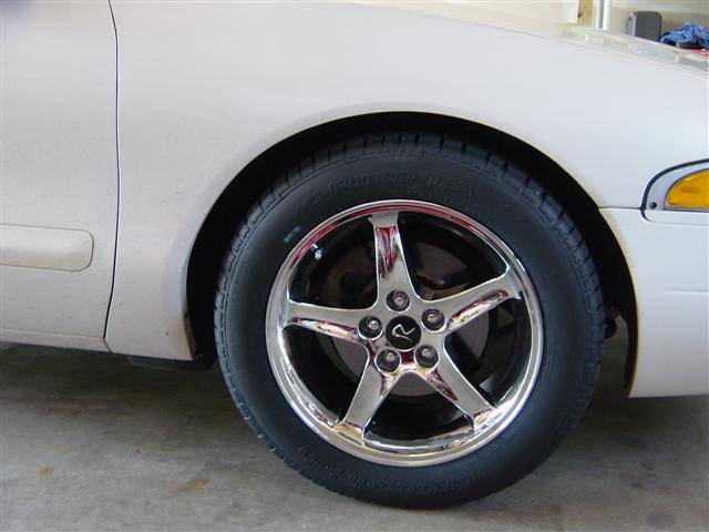

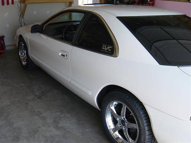

Ok I ended up with 255-50-17 and they just fit-I have no idea how you guys got 275's to work-but god bless you.They had to shave the control arm a hair cause the letters on the tires were hitting it.:(
ok just got my Alignment done and am all set-just a warning,if you sensor lower your car get it aligned-mine was way out-heres a couple of pics-sorry havent washed the car in a week or so.
