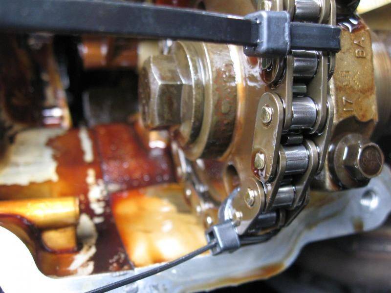

The tensioners and guides look fine and feel solid with no noticeable slack in the chains, still have to pull what appears to be the water pump off to gain access to all of the timing cover bolts.

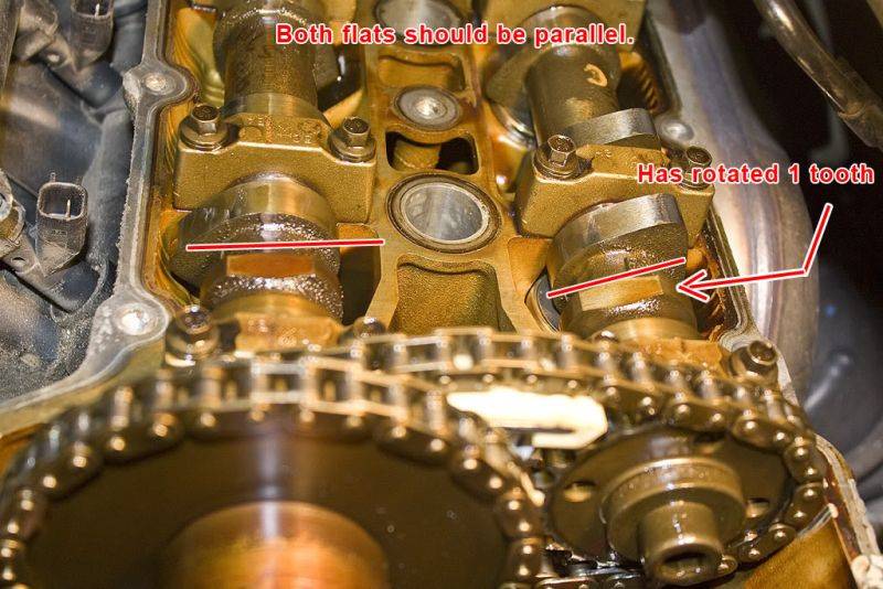

Do the flats at the front of the cams line up?
they are not visable at the moment, but i have not had a chance to crank anything, dont have access to the crank pulley yet and the weak-ass motorcraft battery was dead the morning after I parked the car
