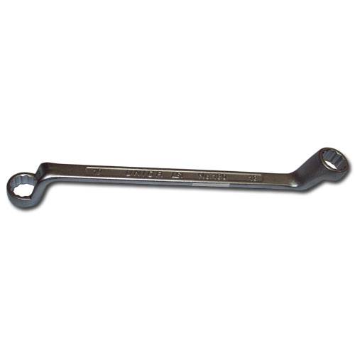

A 7 MM box wrench will make getting to the coil cover bolt that is closest to the brake booster way easier. One with steep angles like the picture will eliminate a lot of head aches.
6 point. 6 point. 6 point.
That is not a bolt you want to round off.
A 6pt combination 7mm wrench will also do just fine as long as you "wrench" from behind the motor with your left hand.

I didn't have one of these wrenches when i did mine either. Lol. I had to break the cover around the bolt. I was out of options at this point.
My recommendation is get that wrench, and get a nice set of extensions and elbows. It should be pretty easy from there.

Also discovered that no one around here has a 7mm box wrench or a 6 point. They start at 10 and 8, respectively. So... Wish me luck... I'll have to be real careful...
Yup, went to Sears first. They're the ones who had it down to a size 8mm. Tried Pep Boys and Lowes as well.
