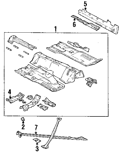

I was wondering if anyone has heard of using the cross brace from a Thunderbird for added strength.
If you are talking about shock tower brace, the Lincoln LS has a brace that runs just under cowl at the top of the fire wall.
no there is a large x shaped brace to further strengthen the subframe of the unibody on the convertible.
It will be too short, the wheelbase for the Tbird is shorter.
ford calls the part a rear cross bar, the underside of the ls appears to have all the mounting holes for this part.

the t-bird lost a lot of torsional stiffness when they chopped the roof off the DEW98 platform. All the extra bracing to stiffen it added weight and hurt it's performance...
The question is will the bracing actually help the LS....
generally speaking, stiffer body = better handling... but it might not stiffen a damn thing, and they are called general rules for a reason. I say fvck it, do it up and see what happens.
Here is the exploded view from ford showing the cross member(part #7). it is similar to how the M3 uses the same brace as the 3 series convertible to attain chassis stiffness. Ill take pics on Tuesday when the part shows up.

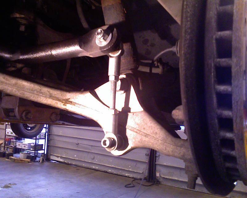

Here is a pic of the sway bar links i made. i didn't like the factory parts so i decided to make my own.
