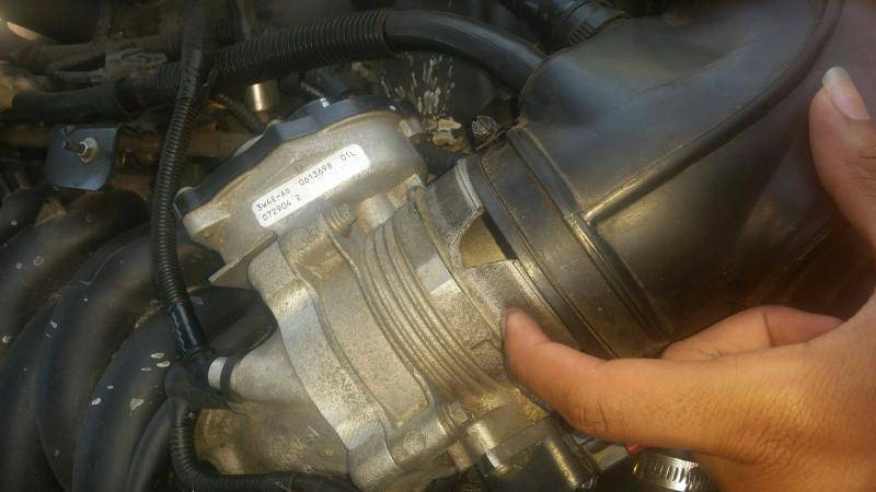

This is the chip in my throttle body do you think its this or might be the coil packs?? I know you thinking its pretty obvious that its the throttle body but please help me out
Again..... NO coil packs..... It's COP; Coil On Plug. Each plug has it's own coil sitting on top so no coil wires either.
Yes, you need a new throttle body. I would check a junkyard as the TB rarely fails.
It looks like there are or were some coolant leaks going on there too...
Maybe that was a junkyard throttle body someone replaced trying to fix the etc fail safe.
Trying to think of any other way a chunk is missing like that other than it being thrown around.

Yea I don't know how in the world that happen but I was just trying to make the light then it when into fail safe mode I wonder if I was just pushing it to hard
Oh boyy that's a lot of work and im scared to do it has been broken for a while so the piece might be already shredded......
I doubt it would make it past a valve, but if it had made it into a cylinder, your engine would already be toast. You'll be removing the manifold to replace those cooling system parts anyway. I can see evidence of the leaks in your picture, can't you?

Trust me, you didn't unless you replaced a whole bunch of parts. It'll probably be over $1K if you have to pay someone to do it.
