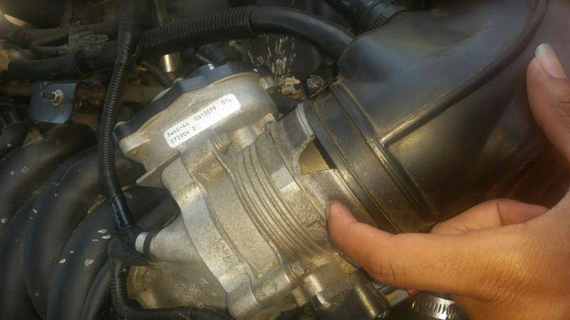

Throttle body PLEASE HELP
I have a throttle body for sale if you need one. But you need to change the COP's and spark plugs if they havent been changed yet
How much for the throttle body?? And where can I get some motorcraft COP's from ford sells them right??

personally, I agree with joe, I would want to make sure that chip isn't anywhere in the intake sitting around waiting to destroy that motor. I would probably still want to replace it as that chip doesn't make me feel all warm and fuzzy inside. I would probably replace it first just cause i would be worried that the hole from the missing chip is allowing some amount of undeterred air into the engine since it looks like it might be a tad too big to be fully covered buy the intake tube.
I really don't expect that to fix the original problem so I would also be expecting to still replace every coil and plug if the problem remains (but then again, something bad had to happen to the TB for that to break like that so who really knows...)

The intake tube is covering the hole but I think some how the little gap of air is messing with the air somehow so yea I need to replace it and thanks for giving me the low down on the coils I am new to this
from the picture, that crack looks like it goes right up to where the end of the intake would be. and if any air is getting sucked in, its too much IMHO.

And as soon as you get it straight and are enjoying the LS, Another Problem will occur!!
Ill bet someone put a screwdriver in there and tried to pry the boot off and cracked the intake.
That would make sense. The rubber can stick to the metal, even after loosening the clamp. The trick is to twist it.
Yep, because if you ever tried to take it off, for the 1st time like I have. It don't come right off. Its a PIA to get off.
