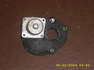

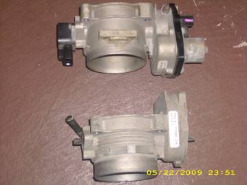

It's an '06 F150 throttle body housing, 75mm :D with the LS external parts bolted back on. Problem is the stepper motor is not offset like the stock LS's so you have to modify the housing, and motor cover so it clears the valve cover.

The bottom TB is stock LS, the top is the new one. The stepper motor cover, and housing is shaved on 1 bolt ear to clear the LH valve cover when bolted to the intake [This is a GEN 2 car, now GEN 1 might be different]

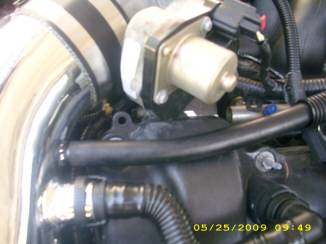

The TB looks like its touching the valve cover but there's a c hair of space between them.
