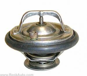

I have heard that you can test a thermostat in boiling water, is this true?
If so what I am looking to happen?
Overheating 02 LS V8
It works better if you have a thermometer. Hang the thermostat in a pot of water with a wire so it doesn't sit on the bottom. Heat the water and watch the thermometer as it gets hotter. The thermostat should open around 190 - 195°F.

Well I got the thermostat out but broke the thermostat housing in the process. I am in the middle of trying to replace that but the 2 bolts in the back are IMPOSSIBLE to loosen or tighten back down. I had to break the remaining housing off the enging to get the 2 back screws off. Great idea, except it doesnt help me with getting them back on with the new housing I bought! Any ideas?????:confused: :confused: :confused: :confused: :confused: :confused:
As far as the thermostat goes, my old one was def bad. I put both in a pot of boiling water and now I see what it should have been doing.
I removed the air intake tube when I changed my tstat. That made everything REALLY easy to access.
