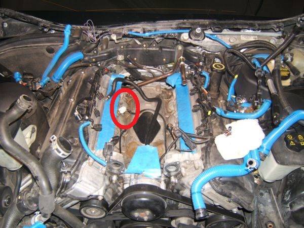

no - it is under the intake just inside the back intake port on the passenger side.
like I said - no - it is under the intake just inside the back intake port on the passenger side.
