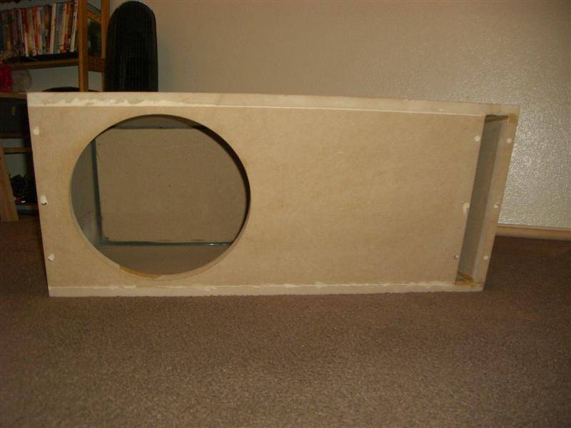

So as some of you may know Ive been shopping around and stocking up on supplies to beef up my electrical and install a new sub set up. I am still waiting on the sub and amp so will not start my installation probably until early next month.

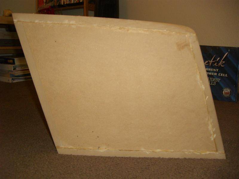

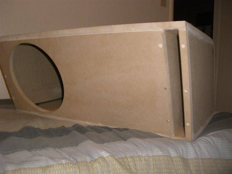

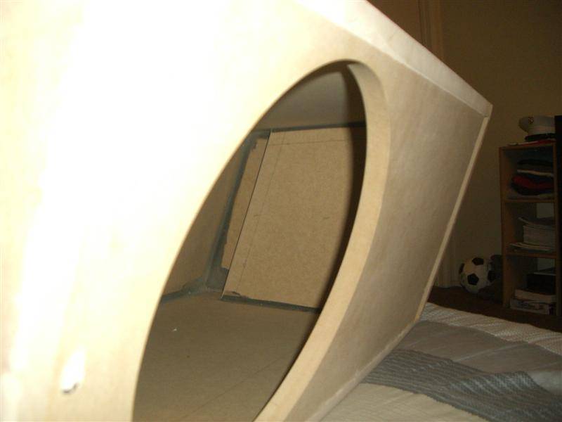

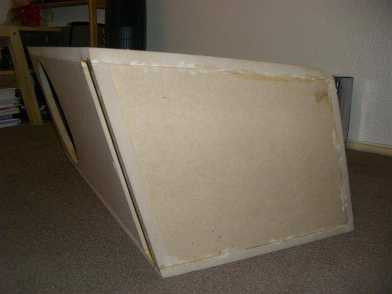

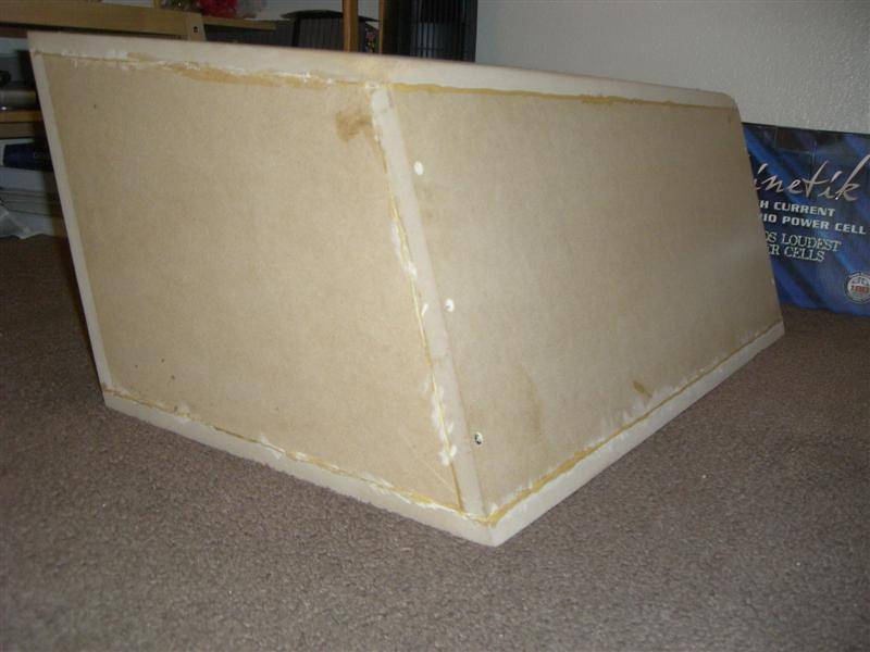

Heres just a few pics of the nearly finished sub box. Still need carpeting and bracing. 2.28 cubes (after sub and port displacement), tuned to 34.99 hz. It is made out of 3/4 mdf.
I beleive this is the biggest sub box you can possibly fit in the LS without removing the stock subs, having access to the spare compartment and withough having to notch the sides to accomodate the trunk shape. In one of the side pics you can see how i even had to sand down the back top corners in order for the box to push in a few more cm to allow access to the spare compartment. We even angled the top of the from baffle forward, in order to gain a few more squar inches. We could not angle it too much as then the subwoofer magnet may make contact with the upper part of the box. A very very tight fit.
I will start a full install and build thread once my sub and amp come in.

Its actually for one 12". I dont think an 18 would be possible and keep the access to the spare. The max height of the box you can fit is about a 13 1/2" and thats only the front because the tunk gets narrower as you get closer to the rear seats. This is the biggest thing you can fit in our small trunks. A box like this one could work well for 2 12's, depending on the subs you plan on running.

I'm actually going to run a xl 12 in this box. Hopefully the specs of the box will suit the sub well. Now got to wait on dc for the sub. I baught an aq 2200 for it.

We were lucky. This box is such a perfect fit. An cm more in any direction would of been a disaster.
Won't finish the box until I get the sub. Need to make sure the motor will clear the top of the box, pretty sure it will. Gotta be ready to modify if necessary.
