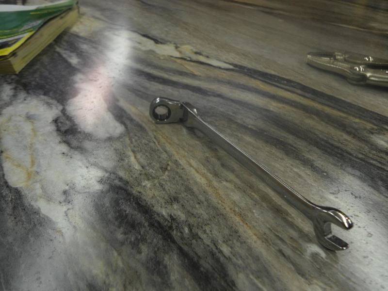

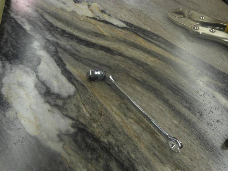

Found this at the hardware store for ~$12. I'm thinking it should do the trick:
Made by Gear Wrench, 8mm, ratcheting, and can pivot 180 degrees. Throw a vice grips on the top, and I think it may just work!
