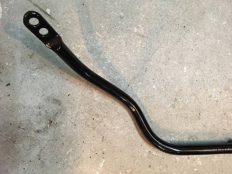

    I’m trying to locate a heavy duty or thicker sway bar for my 05 LSV8 sport. Any suggestions on where to look or companies to contact?

    With the 'Sport' suspension, you already have a 30 MM front bar. Why do you want more?

    There is a lot of body roll when cornering hard. I just replaced all 4 struts. The car rides and handles great but for the roll

    Most that I have heard from who have installed Monroe, were unhappy with them. I doubt that the size of your sway bar is the problem.

      From my information the front sway bars for the V6's are slightly larger than the V8. V8 sport is 31mm. V6 sport is 32mm.
