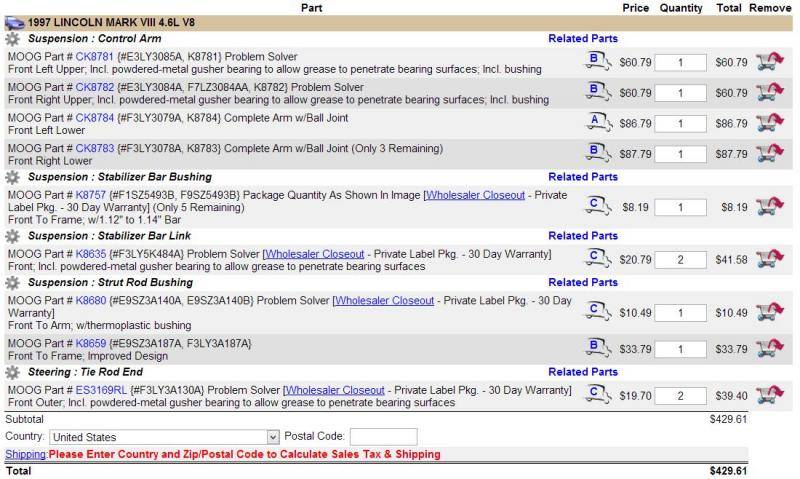

Hi guys - so I am comparing part numbers from Moog listed in the thread vs on RockAuto and they are all almost different. Also, what is the proper "diameter" of my front swaybar on my 97 LSC? Seems there's a bunch of different sizes...
You're paying $60+ more than you need to on those lower control arms compared to the price on Amazon.
