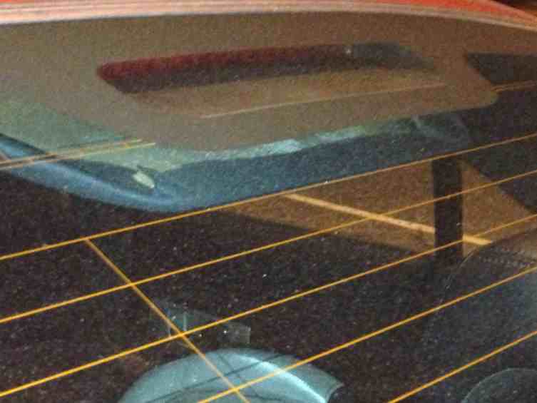

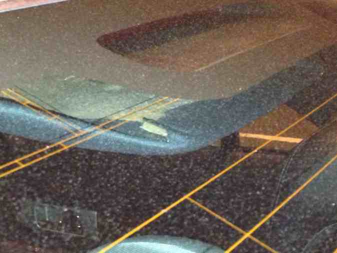

ImageUploadedByTapatalk1393346015.568452.jpgImageUploadedByTapatalk1393346028.132474.jpg
I quest it's a clamp or something that's popped off
Search a little, it's happened to pretty much every gen II LS.
It's not a clamp. The Velcro has come unglued. Various solutions are discussed in the forum. I just glue it back every so often.

I glued in some industrial strength Velcro with Gorilla glue a few years ago. It is still holding.
I went gangsta on that and piled a big glob of epoxy adhesive In there and held it in place for a minute. Hasn't came loose yet LOL
you would think the glue you can buy to rehang the rearview mirror would work?
Never say never, but that's for gluing metal to glass. There's no glass involved here (although I can see how you might think that it does from the picture). The problem here is to glue the headliner to the metal bracket under the third brake light. Then it comes close to the glass, but doesn't touch it.

Even if you didn't search, inspecting the headliner it's pretty obvious that it just needed to be reapplied with adhesive.
