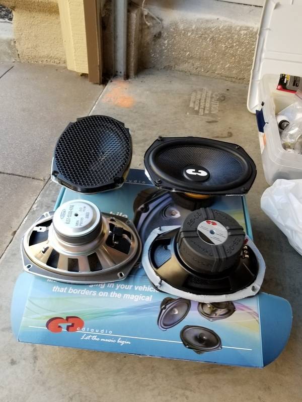

Comparison stock vs. CDT
Installed
I took the CDT logo off the speaker grill and added to the stock ;)

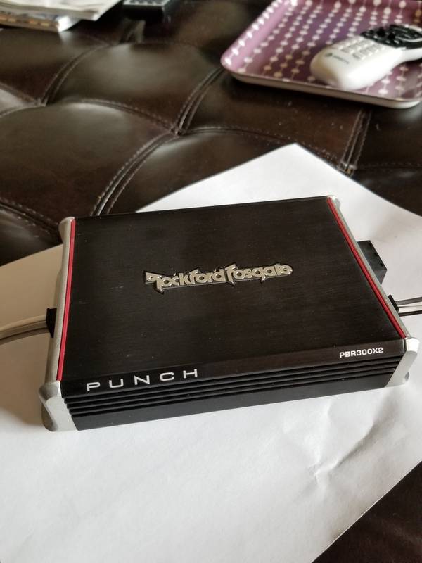

1Loud - Love this little amp and thanks again for the recommendation!! Seems very well made and has some heft for its small size ;)

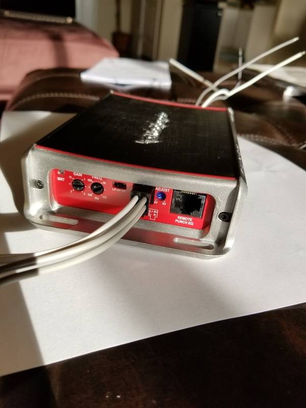

Just to confirm I will be using the speaker wires OUT of the stock amp to the inputs displayed below (White +/- Left and Grey +/- Right. Should the Blue "Adjust" be set at 4V or 6V or in between ? Any recomended starting point for Gain and Freq settings?
yeah its a pretty darn good amp for such a tiny footprint. I've used it a couple of times on Harleys cause it can fit under the faring pretty easy.
correct.
I'd probably start with it turnedall the way to 6v. since the amp has a little more power than the speakers can handle it will give you a little extra safety room. I'd also set the X-over to "LP" and set the freq to 125hz to start and probably lower it a bit once starting to listen to it, but depending on where the mid bass is cut for the door speakers (it cant be too low with how small the woofer is) it might even go up a little bit. all depends on how those drivers sound and what they like. as far as the gain goes, I would start with it turned all the way down, since it is getting signal from a factory sub amp, its probably going to be one of the strongest signals the amp would ever be designed for, especially compared to a factory radio's output or even a set of preouts from an aftermarket deck. with the radio up about mid way(make sure the new amp and subs are not playing unusually loud), I'd take a listen and see if it needs to be turned up at all. if it does, it really shouldn't be much at all. often when installing these micro/brick amps on factory radios I leave the gain all the way down, 10%-15% tops.

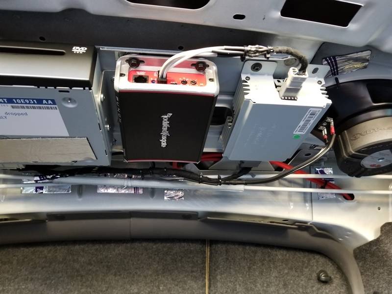

Completed the install over the weekend. Still playing with the settings & have the gain set all the way down to min. In the instructions it said to turn Gain all the way down to where you hear nothing from the radio then roll it up to where you can hear minimal distortion - even all the way to min I can still hear the radio...The Adjust was set to 6v and no pop from the amp at start up so I have not tweaked it further. Additionally, I have experimented with both the All Pass and Low Pass settings. Since I am using the high level outputs out of the factory sub amp I wonder if the DSP is already sending the Low Pass frequencies since I don't seem to hear a big difference between All Pass and Low Pass. Unsurprisingly, the bass is powerful and can easily overpower the rest of the sound system. Thus far the best result, for my listening taste, has been to use the "Bass Reducer" setting on my iPod.
Thanks again for the advice

Nice. I still can't believe how small they make Amps nowadays compared to the real estate the older ones took up.
Minor suggestion: on the red power wire going through the metal seatback, you might want to throw a grommet or something on there. Over time the vibrations can cause the metal edge to chafe through the wire insulation.
Good idea - I will do that

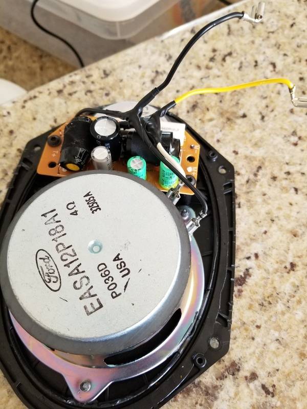

Followed RollinLS 's "How To Article" on modifying the Stock 2-way speakers - pretty easy and noticed an improvement in the sound quality.
