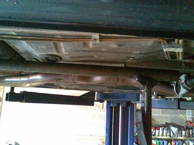

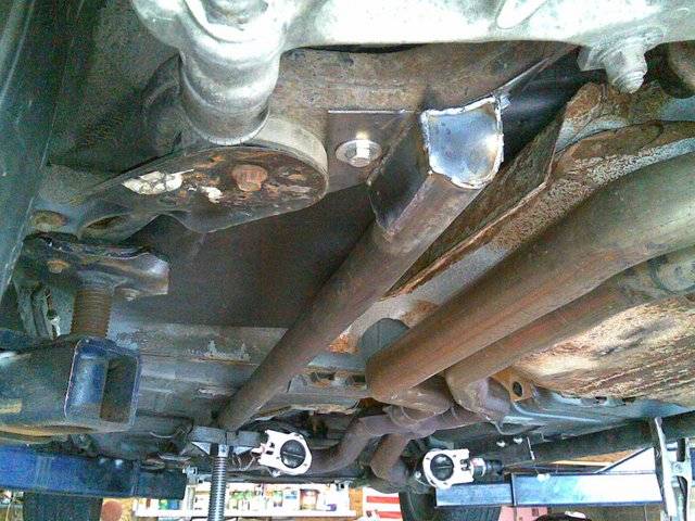

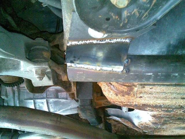

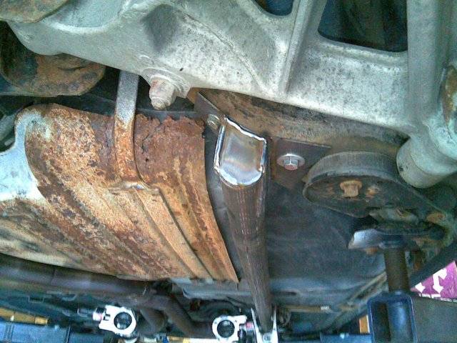

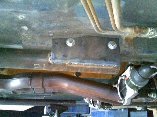

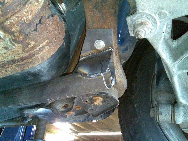

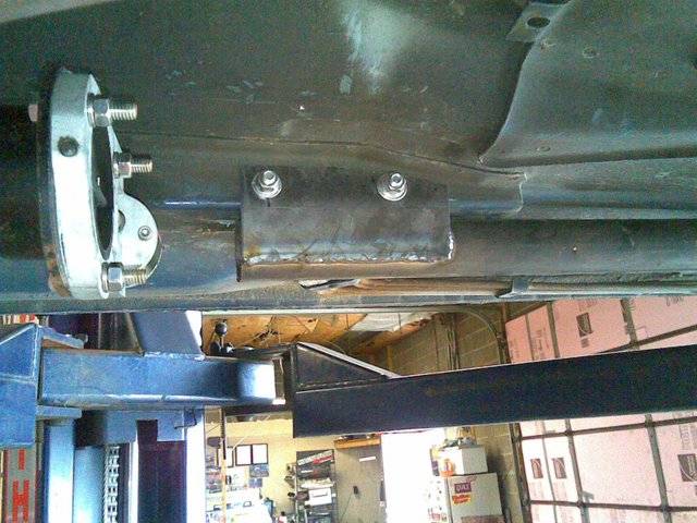

For the people that have them.....could we get some dimensions....I am wanting to have a set made. I will use the search feature for the pics of attachment points and such, but would like some dimensions. Size of tubing and such would be helpful also.
I had mine made from 1-1/2" chrome moly tubing. You need about 4 feet for each one.
The pics should give you a reference to go on and measure on your car to see how long the tubing needs to be. Mine were fabricated in the fly at the same place that did my exhaust. He had tubing and plate on hand since he also builds roll bars and cages.
