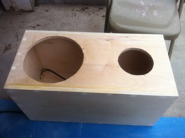

So, that other thred of mine got a little off topic, so I'll just post the progress pics here.
I took some good pics of the actual box building, but don't have my camera with me at work. These pics I took with my iphone.

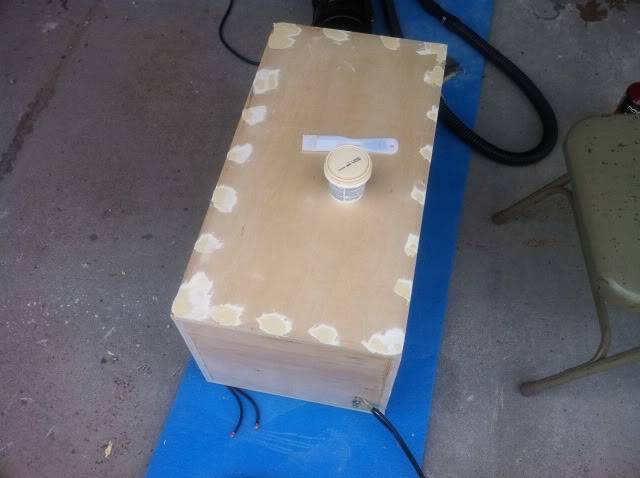

Filling screw holes:

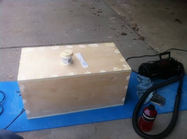

Sanding the filler down:

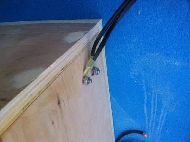

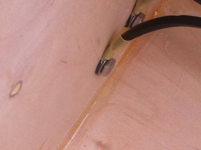

And here's the wiring I did. Stainless steel bolts, washers, nuts, and lock washers. And to seal it off, I bought 2 rubber washers (1 for each terminal).
The order from the inside:
bolt head
flat washer
ring terminal
rubber washer
And the exterior has the ring terminal, lock washer, and nut:

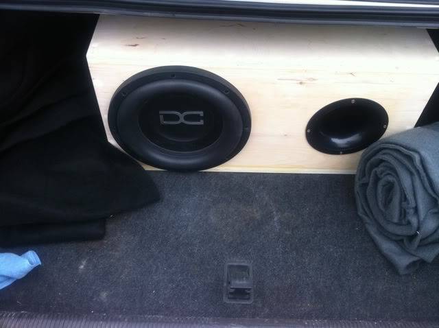

And in the trunk. Going to pick up carpet today:
looks pretty good. how much in materials did all that run if you dont mind me asking
I have access to a custom cabinet line (I'm part owner of a retail cabinet shop). They precut all the pieces for me (I gave them the cut list), so all I had to do was assemble. So the birch ply, precut, was around $50. The stainless steel bolts/nuts/washers/etc. were about $3 at a local fleet store. Then ring terminals and 12 guage stinger wire were about $10. Aeroport was $10, but cost $11 to ship :eek:

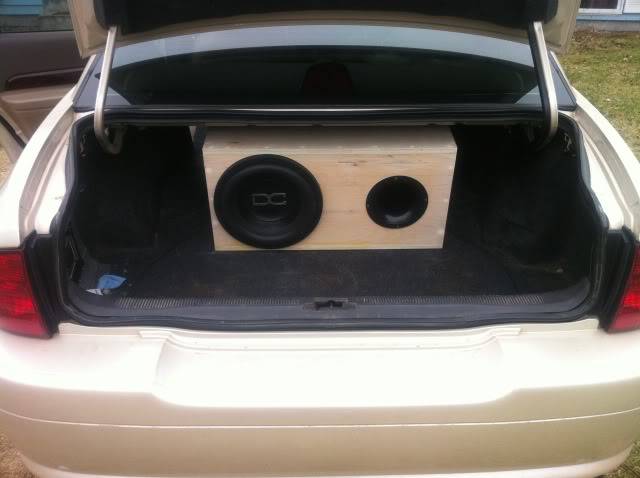

Looks good. Can you get into the spare tire or is the box too big?
I'll have to pull the box. No biggie though.

Here's the photo of the 2 carpets next to the box in the trunk:
Ask the guy on ebay what carpet he uses...i have the box and its a perfect match.
It was between that and Bella tempo. I'm going to Bella.
Very cool man. I'm a big moe. and Wiz fan so it should be pretty fun. I actually took my LS to Summercamp when I owned it in 06
ask Tru where he got his sheet of carpet, it was a d@mn good match
is that ported to spec? those subs are deadly when equipped right, a buddy of mine has a dc XL 15" running 4600 watts RMS at .5ohm in a malibu. he did a 152.4db. crazy :q:q:q:q
Box is about 2.25 cubes after displacements, and tuned to 33hz. It is delicious. Willbe much better when the lows open up fully.
