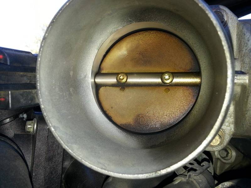

2) TB was pretty bad. (pic 1) Cleaned thoroughly with CRC TB cleaner

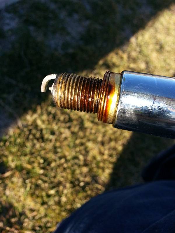

3) A few of the plugs were baked pretty good, and had a good bit of oil at the threads but not on the electrode or ceramic insulator (pic 2). No oil or moisture in wells at all (thank god). Btw I posted this in the other thread but the VCG's were replaced 18 months ago. The new gaskets are doing their job.

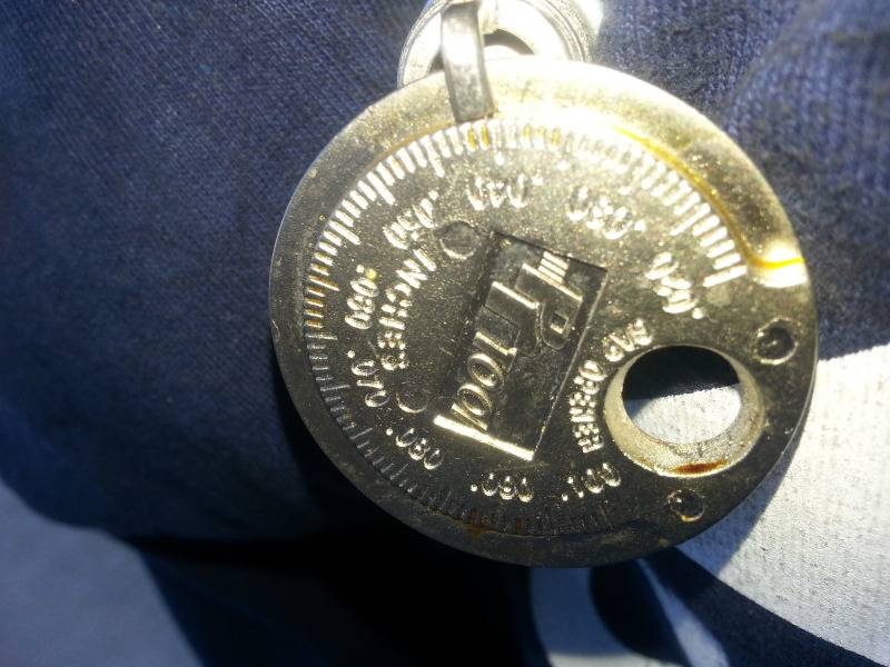

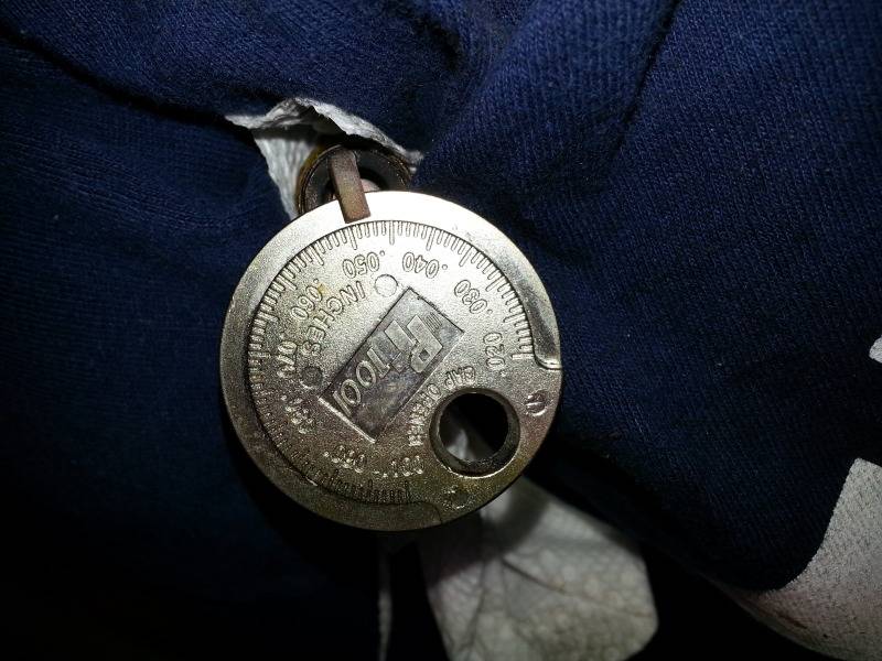

1) All the old plugs had a .048" to .054" gap (pic 3). New plugs were gapped properly at .041"

dirty throttle plate
old plug
old gap
new gap
