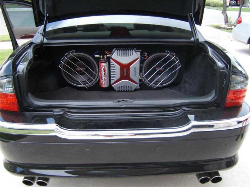

pics of mine:
NICE looking setup Quik! Thanks for the info as well.
