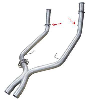

Here I took the picture of my X pipe and put arrows showing where I think my stock o2 sensors that are already in my car should go. The other hole I most likely will just plug to make things easier.
Alright, I'm just taking a big guess here but from what I'm looking at, you'll be plugging all three of those holes up because your 02's are going to be before your high flow cats which are way up higher than what I'm seeing here in this pic. Yes, I would highly suggest going with Motorcraft 02's and you only need two of them. I got mine from rockauto.com for half the price of a local Ford dealer and $20 cheaper than 2 Bosch from AZ.
Some here have never had a problem with Bosch 02's but some have and why chance it when the real thing is out there cheap enough? rockauto will have them to you in 2 days.

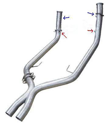

This is an offroad x pipe so there is not going to be any cats. Since there aren't going to be any cats this pipe still includes the spot for the o2 sensors to still be in place. Now I was thinking, our cars have 2 front and 2 rear sensors right? Could I just do this to get all the front and rear sensors in this pipe, where the blue arrows are put the 2 front sensors in and where the red arrows are put the rear sensors in. I would have to get a shop to make another spot but would it work?
This is all getting confusing but I want to make sure everything goes right when it gets installed.
