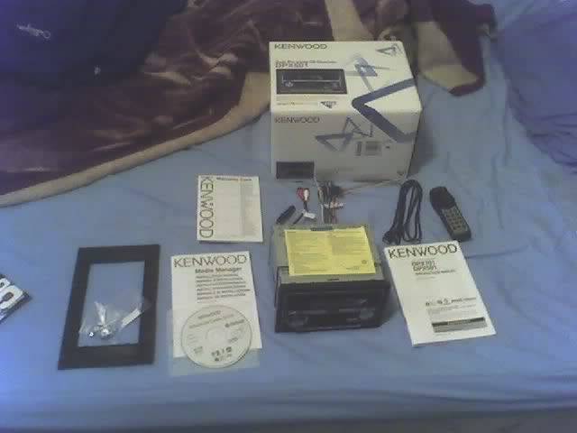

Headunit:
Kenwood DPX501 - its a double din unit, nothing fancy, if i wanna watch movies, i got my DVD player at home, ill ask for directions if i have too.....just want to drive with my tunes going.......anyway.....
1. the opening on the dash needs to be opened up about 1/4" (maybe less) more on top in order for the unit to slide in, how did you double din guys do it? pics would help, i dont wanna hack away all crazy........
2. wiring, i dont wanna cut up the wiring harness, yet......just trying to keep it as simple as possible for now......from Scosche's web site i got the FDK8B as the harness i need, is this all im gonna need? shows 3 harnesses, two for the wiring to the radio and a bypass for the amp, right?
3. the instruction manual (yeah, i read it, since its not running yet.... :D lol ) says i can shut off the internal amp on the headunit......could this mean i can turn off the internal amp and use the JBL amp in the back? :confused: probably wont know till i try it.......

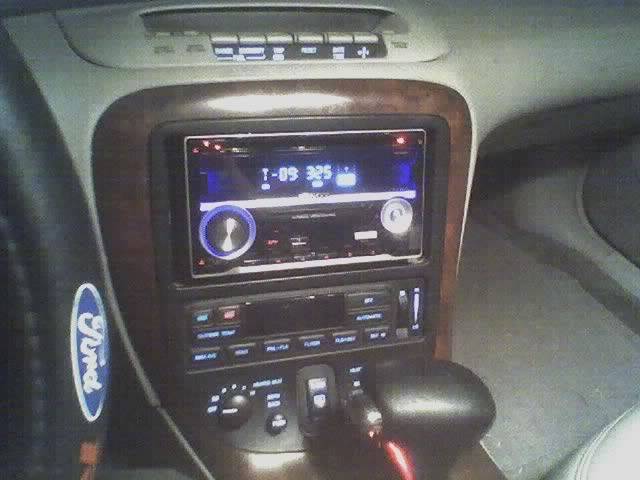

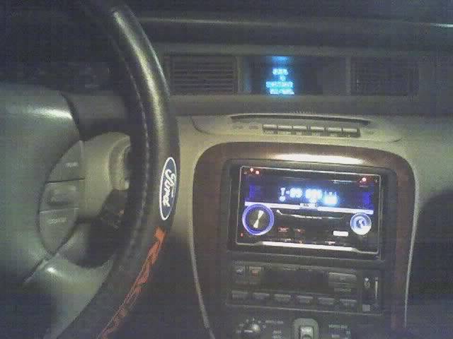

headunit up and running, found the harnesses locally, cut up the dash opening on the top part, and put it in, the fit is very snug, doesnt move at all.....pretty easy after all :D , running the stock JBL amp, crank it up and no problems with the speakers, dont crank it all the way though, its WAY louder than before :)

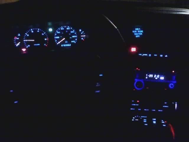

no, the colors on the radio dont match to the lights.....my camera phone just makes it look that way :(
