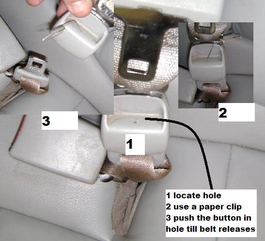

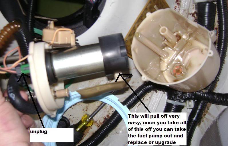

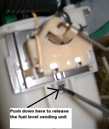

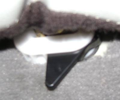

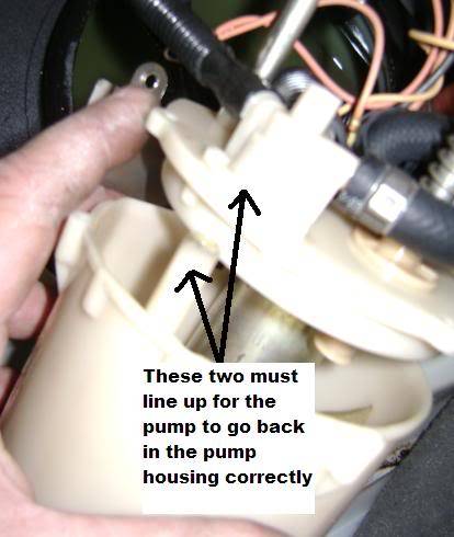

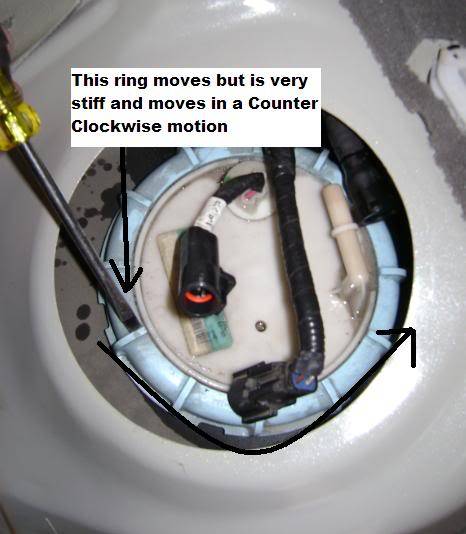

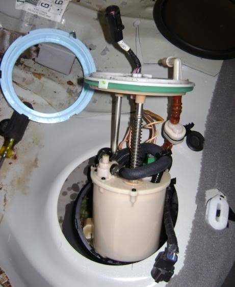

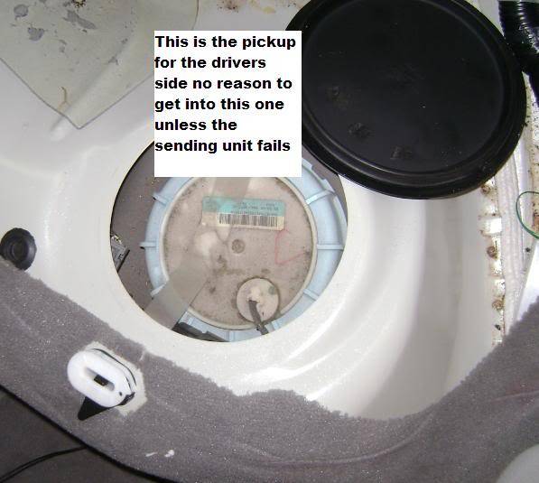

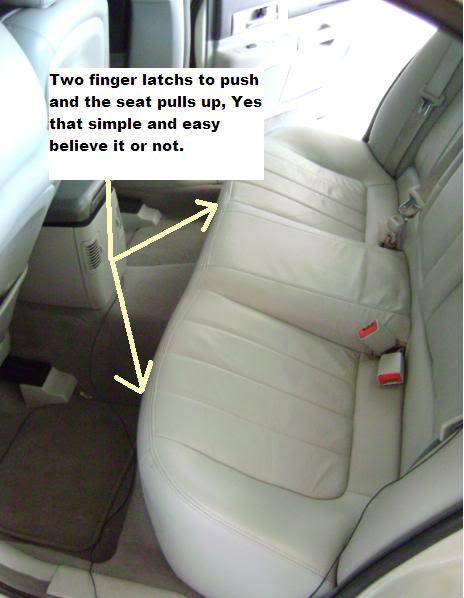

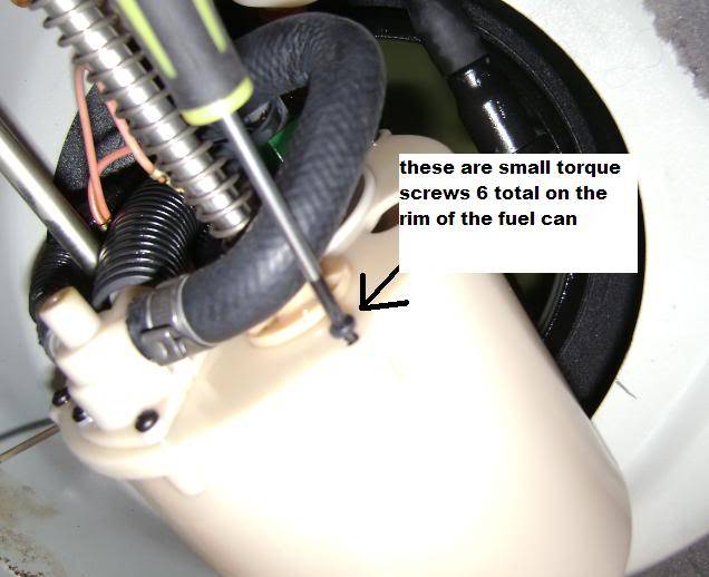

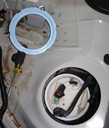

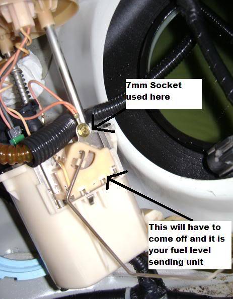

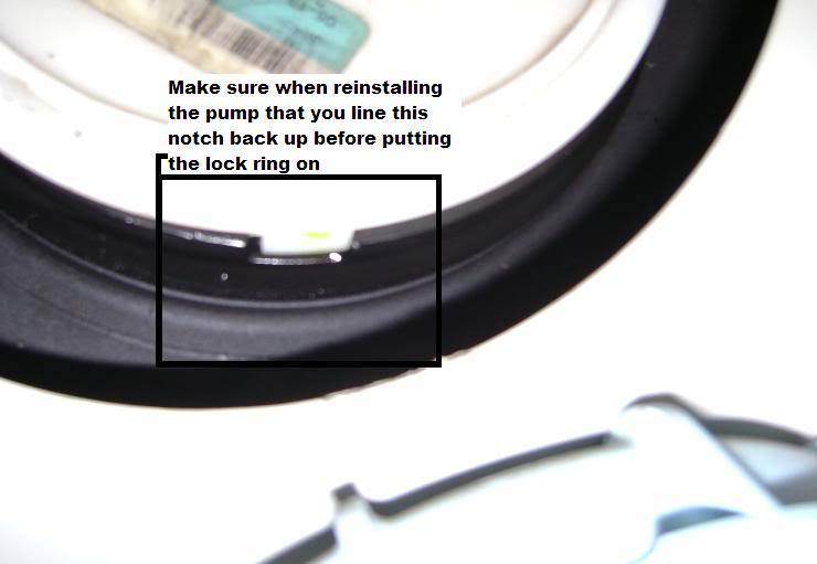

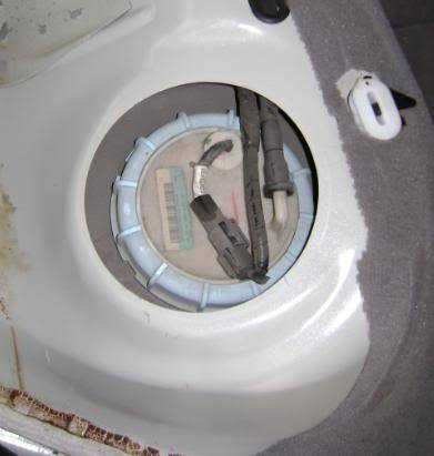

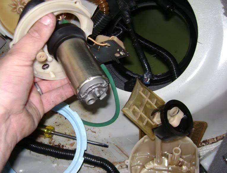

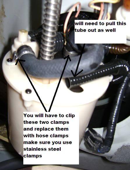

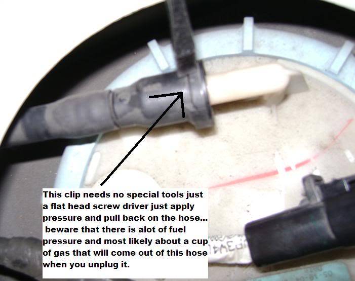

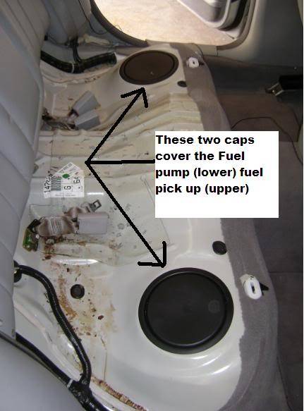

OK I busted into my fuel pump today b/c I'm about to upgrade the fuel pump when I add a turbo to my car. I figured I would take pictures and make notes for the next person who may be replacing or upgrading their fuel pump.
I hope this helps everyone else out who may have an issue with their fuel pump and make its alot easier and cheaper for you to deal with.
Feel free to add to this post to help myself or anyone else doing the same project.

There are a couple of different version of the pump assembly - so you'll have to feel you way through the specifics on opening the housing. Some you do not have to remove the sender, some do not have the rubber hose.
I wrote a similar article for both the pump and jet pump for the LLSOC - the thing to always add...
the manual says to drain the fuel from the tank first..... (although I never do)... and you can buy a retaining ring tool for $14, which make not only removal but re-intall easier.
No problem just figured if someone like me needed to put a pump in and didnt know any better I may spend a lot of money on letting someone else do it when its really not a hard process. May take a hour and thats if you have to goto the parts place to get the pump. This is on a 2004 LS with a V6
By the way where do you get a manual... who makes one. I've always worked on mine by just looking at what im working and and going from there. Just like the fuel pump I just knew it was under the seat from seeing one taken apart at a junk yard.
e-bay - I bought both printed manuals (shop, wiring, ..etc) and the actual DVD off e-bay. Many of the Ford only tools are on there as well - since many dealers closed there doors...

Assembly install very simple on '02
I had a hard starting problem that seemed to be related to lack of fuel pressure at key-on. We all know you should key-on and pause just a bit for the pressure to build up before cranking. Apparently there is a check valve in the system that keeps pressure in the lines after key-off for those who go directly from off to start in a tenth of a second. I admit I'm impatient too and I'd recently noticed that a quick crank resulted in a very hard start. After researching the issue here I began to think my check valve was leaking. I guess that's not too bad for 142k miles. Given that I didn't know where the check valve was located in the assembly or if it's in the pump itself, and that Ford designed the assembly to be replaced, not repaired, I opted to order from Max Z. at FiveStar Ford. It was a good decision.
The assembly pictures above are slightly different from above but the idea is the same. First I released fuel pressure at the rail using the Schraeder valve and a rag. Then removed the seat and pulled back a barrier. Pop the rubber cover out with some verbal encouragement. I had two fuel lines and the electrical connector. The fuel lines released by pressing in two ears/buttons and the line pull up and out. The replacement assembly came with plugs so I could learn how it worked there. The lines in the car don't have enough room so I had to bend them a little to get them out of the assembly. It occurs to me that doing this on a much colder Michigan day wouldn't have been good for fear of breaking them. I used a block of pine and a rubber mallet to coax the retaining ring off. To remove the pump I had to release two tabs, again looking at the new assembly for reference helped. The new assembly dropped in and the whole job was complete in about 40 minutes. In four starts since I haven't seen the hard-start even with quick key-off to crank transitions. We'll know after this week if that really solved the problem.
