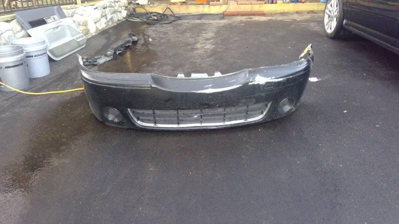

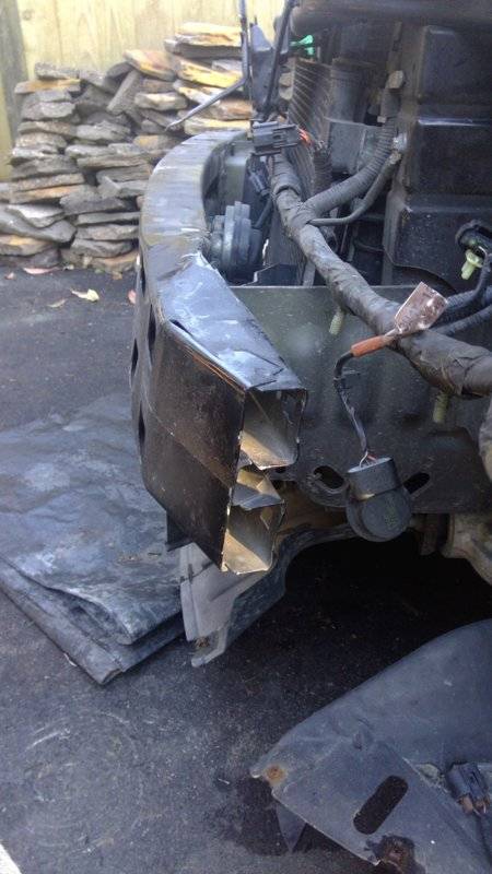

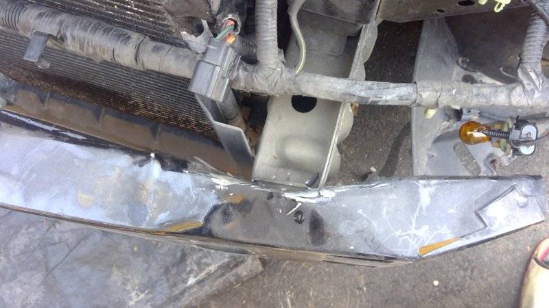

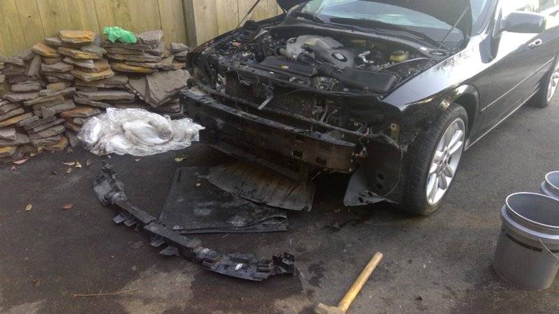

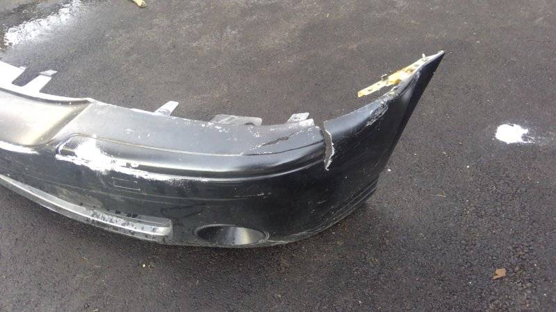

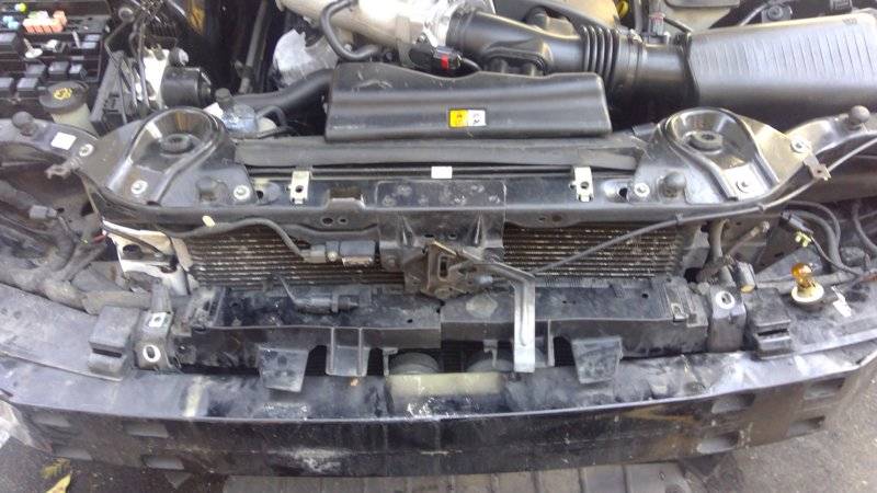

My accident wasn't as bad as I thought. Going to fix the rad support and leave the metal crash bumper. The driver side is pushed in about 3/4 of an inch so im going to get a new styrofoam impact insert and glue some thin strips of styrofoam to build up the driver side so my bumper will sit evenly. Pretty happy. Going to do a much-needed oil change and buy new coils and plugs.
if anyone knows the type of plastic the bumper is made out of it will make my life a lot easier because im plastic welding the tears on the bumper and I need to know what type of rods to get.
The plastic code is printed on the bumper. But I believe it is just the standard ABS plastic rods needed. Be sure to use mesh on the backside.
