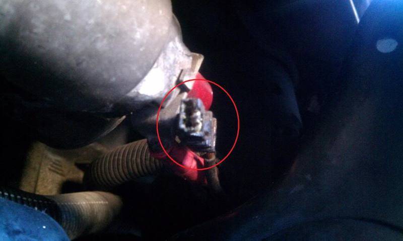

Ya I knew that already... Dont want a shocking experience. Hahaha But take a look at this... When I went under to check the starter connections I pulled off this small nasty wire... I think its my problem. What say everybody?
Yeah, that would be a good place to start.:)
My red car did that for a while, it would randomly not crank and then it would crank right up. I cleaned it up and tightend it a bit and it was fine then.
I think I solved the problem... but now killed the battery because of starting it and shutting it off... Oh well I will let it sit on the charger tonight and see what happens.
