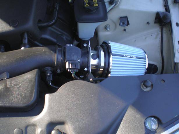

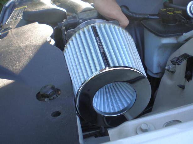

So while at OReilly's today I found an MAF adapter plate for 12 bucks along with a cone filter for 25, so I picked them up to try them out. Anyone know anything about Spectre? I'm assuming that there are differences in cone filters that affect performance. This one does have the open top with fins going inside of the filter too.

Got it installed. I can notice a little bit of a difference, but I had modified my stock air box before I upgraded to this, so the change wasn't as drastic as some others. Right now it's in the engine bay without heat shield, only because I didn't have time to go to the exhaust shop to get the one piece 3" tube to go into the fender well. Hopefully today I can get there.
JWerner, after it's on for a little while, I'll inspect the MAF to see if anything is getting through/coming off the filter. The biggest thing that concerned me with the filter was that it came pre-oiled. That scares me, because I don't want it to be over oiled, then have to worry about it caking up my MAF.

Pektel, I would have just cleaned it first in that case and then re-lubed it if you would have liked.

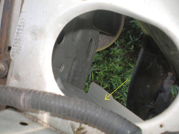

Pete - there's a bracket that goes from the inside of the fender towards the radiator support or there about. If you get that piece of pipe too long, the filter will be sitting at almost ground level. If you get it too short, that bracket will get in the way. At least it's there on the Gen IIs, since that's the problem I had when trying to do mine last summer. I'm pretty sure I posted pics of it in the 'Custom CAI' thread if you wanna see what you're in for.
Oh yeah, I've never oiled my aftermarket filters and never ran into a problem.
Thanks, I'll take a look. I was actually goin to pull the wheel and fender liner to check it out better. I'm hoping it will fit just under where I'm running the pipe out of the engine bay. You know I'll take plenty of pictures so you can see what's under there ;)
JWerner, yes I could've done that, but it didn't scare me enough to take the extra time. It didn't seem saturated, and being that it was a white filter, I figured I'd be able to see pretty well if it was over oiled. It was just more of a concern I guess.
Here's the piece I was talking about:

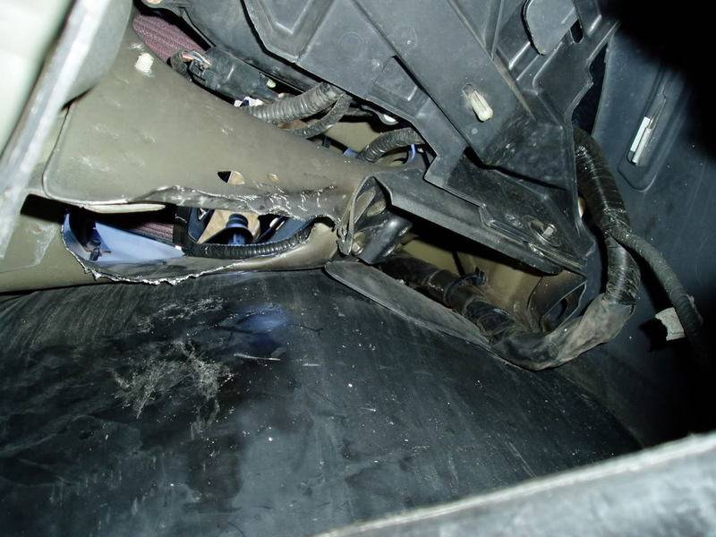

It's the mangled looking piece. lol i have to get a cut off wheel the next time I'm at the shop and get rid of it.
I went and took a picture from the top. Does this look similar?

I am making my own kit. But the only Spectre Items I'm using are the cone filter and MAF adapter plate. You can buy rubber couplers at home depot, although I have one of spectre's rubber couplers I'm going to try first. For the tube I'm using 3" OD steel exhaust tube. I don't think that will break any time soon :D
NYC- am I going to be able to cut that with a dremel? It looks pretty tough.
