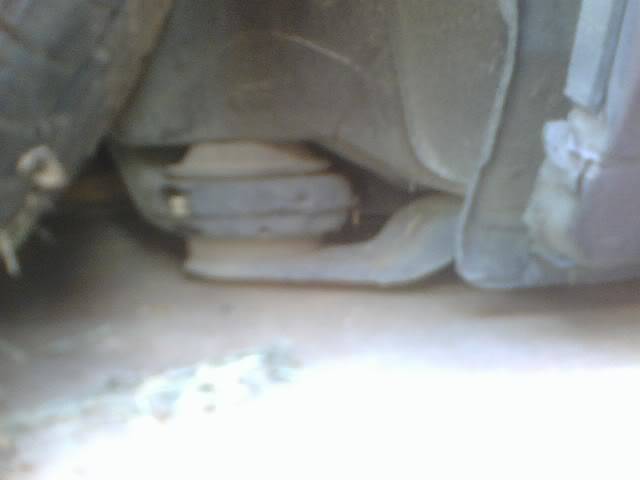

I wish I could answer that for you, but since I changed the car over to fast bags I needed a set of shorter shocks
I dont know whats keeping the car with stock suspension from being on the ground, it could be internal bumpstops in the bags or the shocks bottoming out.
