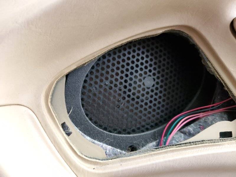

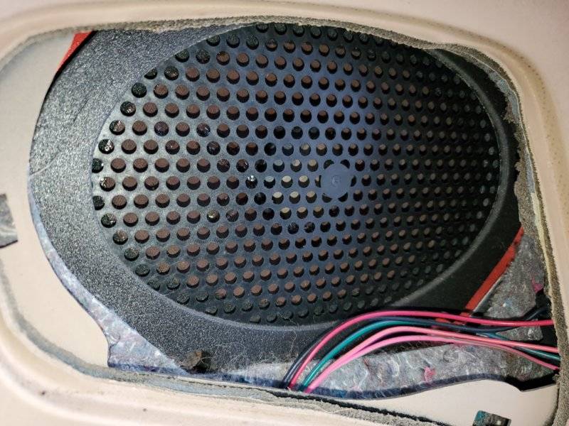

So I got the stereo situation squared away a while back and at the time I noticed it wasn't balanced, like the audio would fade in and out. Well my wife comes home from work a couple days ago and tells me she thinks the stereo is broken or something, I head out sync my phone with the head unit and all but the driver side door speakers are dead I double checked with my multimeter even, so here's the rub I need the speaker sizes I really don't want to pull the door panel more times than I need to. I plan on replacing all with some rockford fosgate either the punch series or the prime series.
Aren't they 6x8"? I put 5X7 in my 95 mark and there was no problem.
I’m not 100% sure, but 6x8 is a standard for Ford. Based on what I’ve read, they should be the same.
I'd have to agree with you the big ones are more than likely 6×8. But what about the round ones?
I used MDF rings for 6.5" speakers and bolten them onto the 5x7 hole and then put 6.5"s in it.
Super easy and gives you lots of room backwards because the ring will space them out = space for thick speakers.

I used Kicker 6X8 in the rear and JL Audio 5X7 in the front doors. Either one of those sizes works fine for the front or rear.
Awesome because I have two sets of Rockford Fosgate punch 6x8's in my amazon cart. What about those round ones they look way smaller than a 3.5 maybe a 1.5" or a 1" tweeter?
