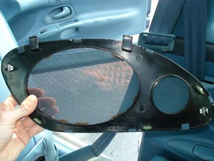

For the rear grilles you pry from the bottom: (tabs are at top)
