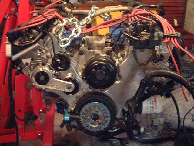

So does that mean you can adjust your timing because in the Mark VIII it is all computer controlled. Right? :L
It is computer controlled through the PCM. But you can adjust the timing via a flashtune or chip or even a aftermarket timing adjuster from Steeda. The colder plugs allow more timing advance to be programmed in.
I have the Steeda Timing Adjuster on mine......look at the blue thing that is attached to my crank pulley in this pic......
