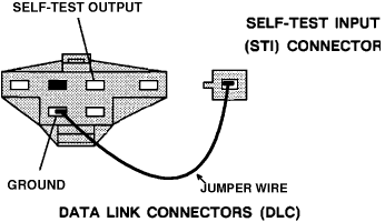

jamie now that u mentioned the ce light mine is on. I dodnt have an idea on where to start? can u help me out of piont me in the right direction
this plug is on your driverside strut cover under the hood.
do this, then turn the key on acc position and count the check engine light blinks to get your codes, then look up the number in the dtc code list to see what your problems are.
