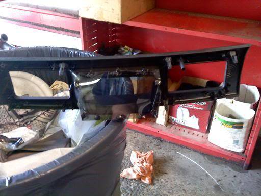

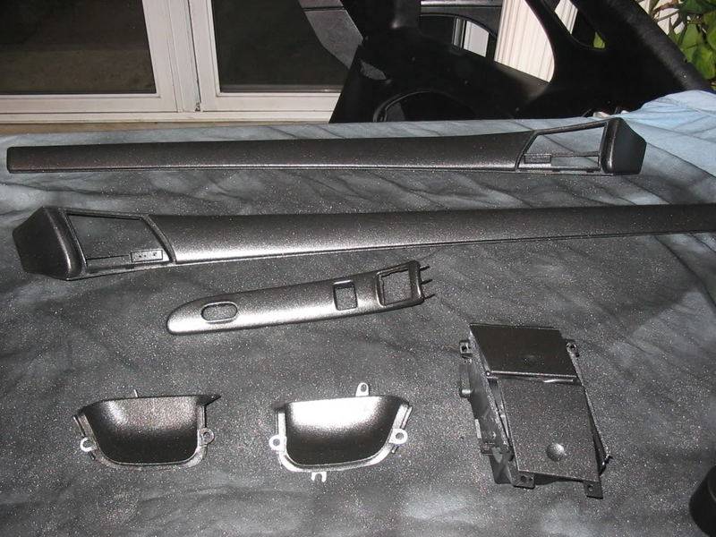

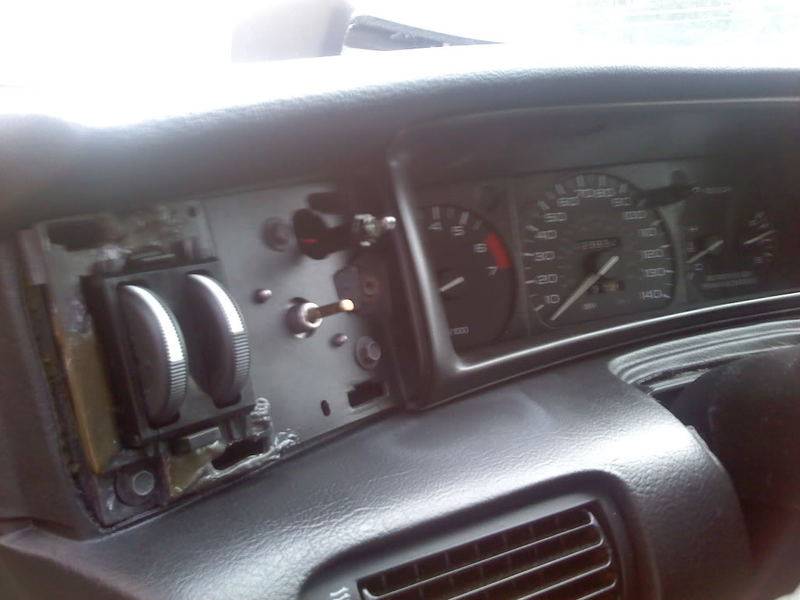

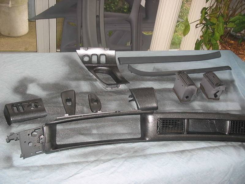

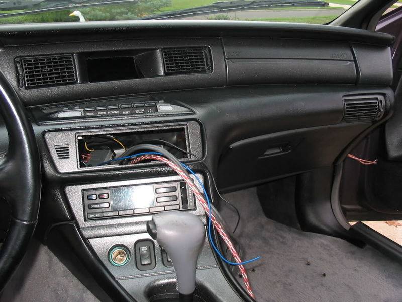

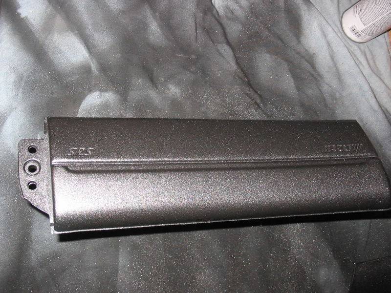

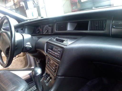

I have spent hours trying to restore the peice of trim that goes around the instrument cluster on my car. It started off when I painted my dash, I removed all the trim and the peice behind the dimmer switch panel was cracked. So, I went to pull a part and got one out of another car. It was cracked, but not broken. So I got all the old funky paint off, which sucked. It wouldnt come off very easily, The paint on it was actually in pretty decent shape, but it was brown. Anyway, got all the old paint off with hours of scuffing and wet sanding. Used epoxy to reinforce the flat area where the switches go, and painted the thing. Primered it, surface had tiny cracks in it from when plastic gets old... Sanded the primer, painted it, cleared it. The clear hazed up, scuffed it again, painted it black... blah blah blah, all this freakin work for 1 peice of trim. Also, because this new panel was brown, I had to remove the old vents from my old black panel and glue them in, and the gray tinted plastic peice that goes over the message center was swapped too. Anyway, I trimmed the epoxy with a dremel, and checked and rechecked the fit of the dimmer switch, everything was good. Installe it this morning, and the flex from tightening the headlight switch cracked some of the epoxy on the panel, then the dimmer switch wouldnt fit right. In the end I got everythign to fit, but when I tightened the screws, the panel broke. Its in there, just cracked in 1 place, but it is separated. I'm just ranting, I've been working on and off on this panel for like 2 months here and there. And when I finally was finished, I chipped the dye on the dash, so I am in the process of fixing that atm.
Just wish all the trim in our old cars wasnt so fragile. I have so much time into fixing trim in this car, and it doesn't really show. You can never see the work because its hidden.
Anyway, just a rant, I feel better now.
