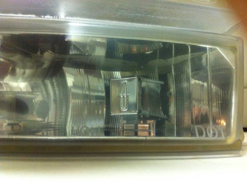

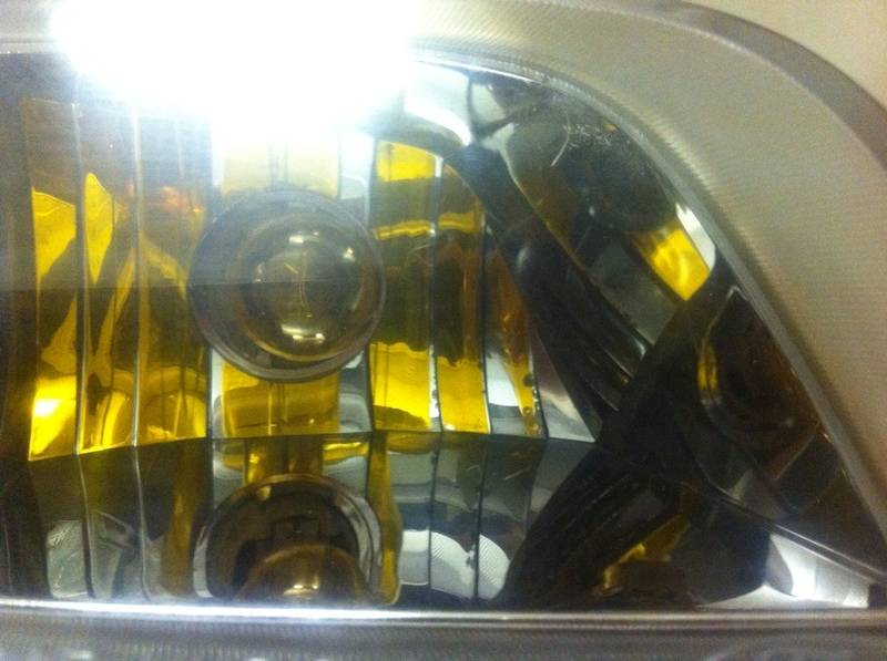

Got a set of 96 LSC headlights from a forum member here for $125 bucks.
The bottom light is virgin, the top lense is finished.
600 grit, 1500 grit, 2000 grit, then red and finally white turtle wax rubbing compound.
Left
Right

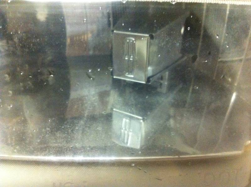

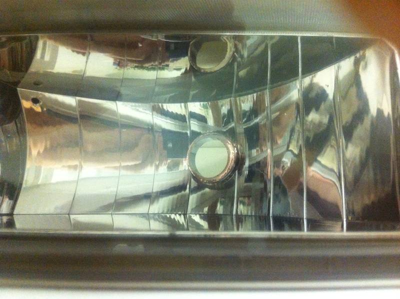

After I refinished the lenses, I put a tiny bit of soap and water inside the housing and rolled a shop paper towel into strips and put them in the housing. Then I kind of shook the housing around allowing the weight of the paper towel to wipe the inside surfaces of the light. It worked awesomely as the inside of the lens and the reflectors were dirty.
I bought the housings to refinish and sell, but they cleaned up so perfectly that I really want to keep them now, but I have not decided. Anyone want to buy some 2 year old mint Halogen housings?

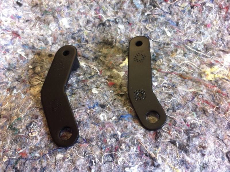

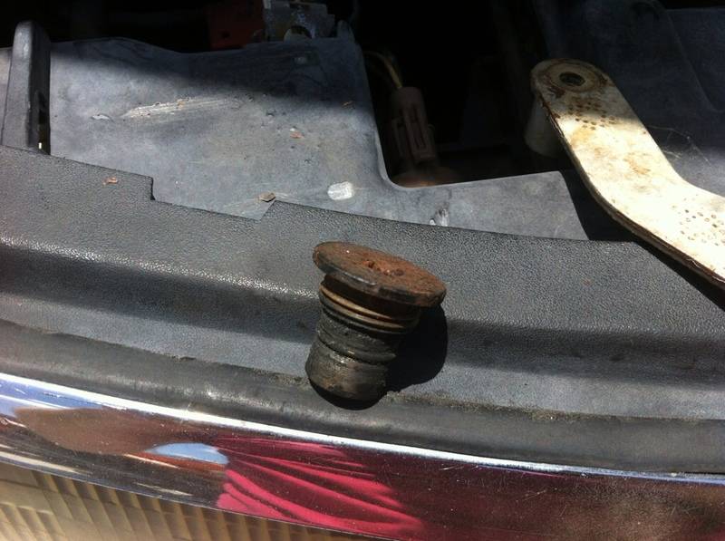

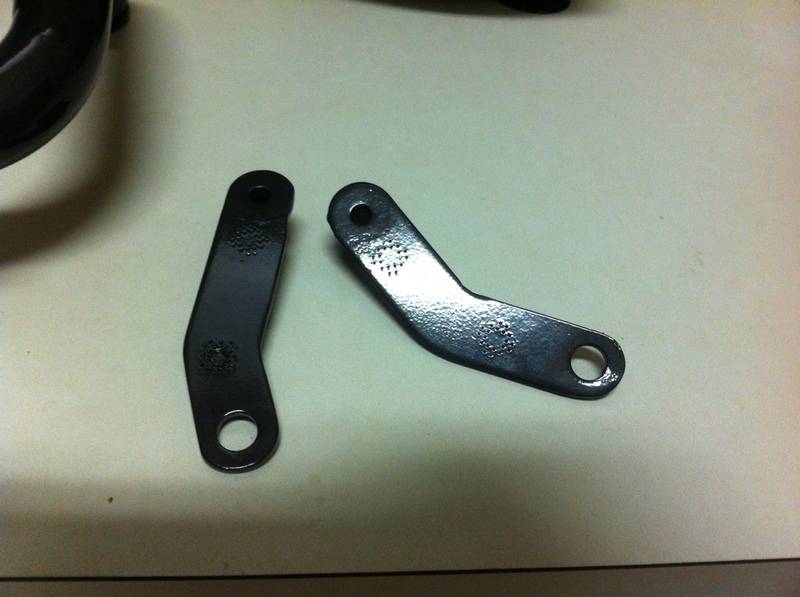

Anyway, here is another item. I needed to make a bracket to hold the top of my alternator, but didn't want the whole arched part anymore so I took an idea from Sapperfire...
Before
During
After

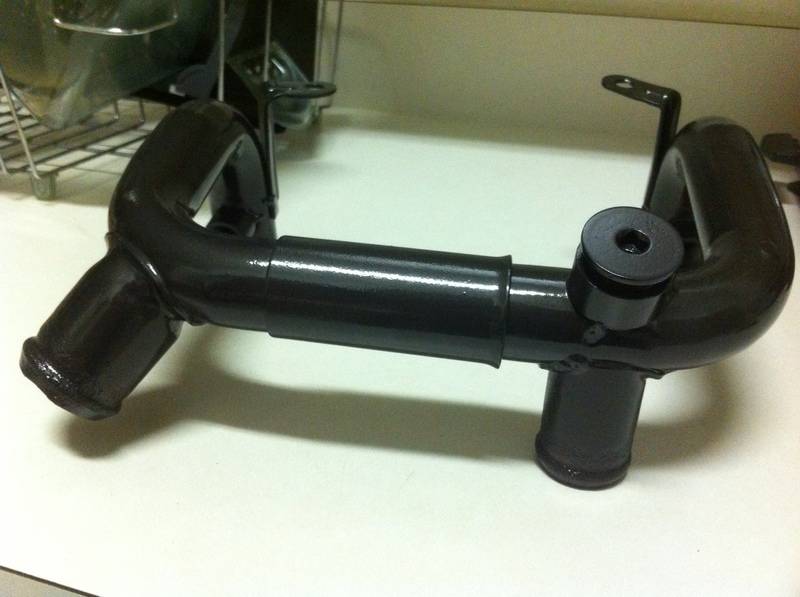

Also a coolant cap for my new crossover tube.
