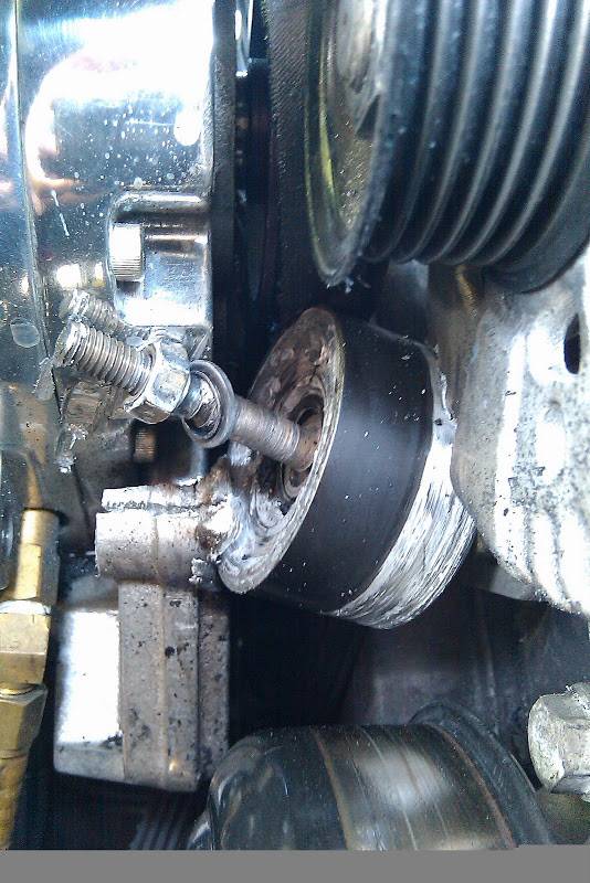

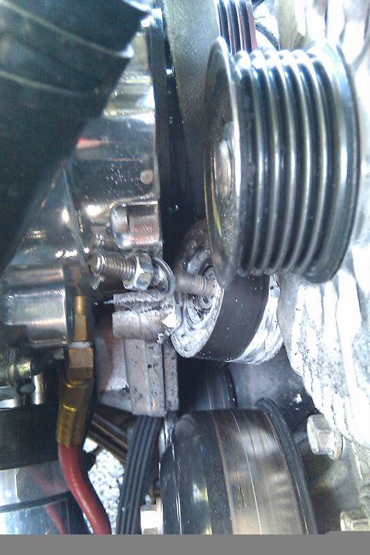

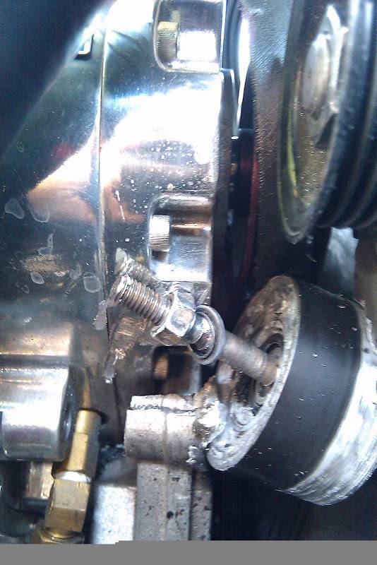

Update - Ryan called and said that the long stud bolt that goes through the Vortech bracket, idler pulley, and into the engine block managed to strip the threads in the engine block.
They are going to helicoil the engine block, and put the thing back together.
The alternator and t-trim took a hit, but they think they will be ok.

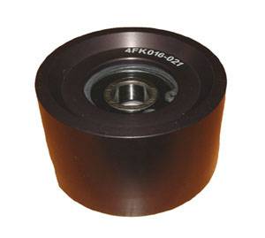

The parts are in, and the idler pulley Vortech sent is totally different than the one that locked up on me.

Went to see the progress today. Miller said he will have it running before he goes home today.
The helicoil went well, but he could not use my spare serp belt in the trunk. He had to send for a new one and trade my spare for the next size larger belt.
That said, apparently, the idler pulley must be larger too.
Here are some nasty camera phone pics.

The Mark is back in action. I picked it up at 5:30, and put it back in it's cave. :) Miller said everything went well, and the 114" belt fits perfect with the new pulley.

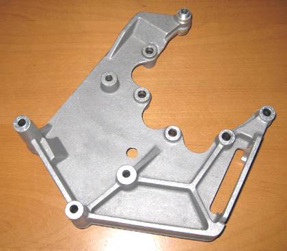

The Gen 3 Vortech bracket with the new idler setup is part number: 4FK100-002. Part number 7U313-133 is the stud and 7F008-020 is the nut for the idler.

Although the bracket did fail, it was not the root cause. It was downstream a little. :)
The pulley failed first. The pulley bearing seized and stopped spinning. Why? Who knows - belt too tight, poor pulley design/alignment, wrong bolt, etc. Your guess is as good as mine.
*Apparently, Vortech seems to think it is their design, since they keep changing the pulley and bracket design.
Anyway, that caused the sleeve to start spinning, and the sleeve welded itself to the stud. That in turn locked up everything and the serp belt then ripped the pulley out of the vortech bracket and engine block.
Once the pulley was ripped out, it jammed itself into the supercharger compressor and alternator taking a gash out of the compressor, and a chunk out of the alternator case housing. lol again, all this happened while turning into a parking lot.
