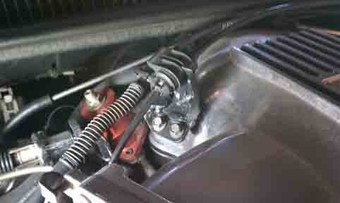

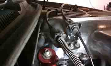

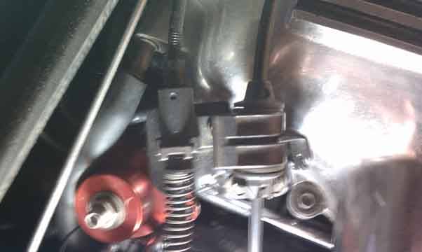

I keep reading about people modifying the gen 2 cable bracket but have never seen a pic. Given the fact that the TB is upside down and that the Cobra bracket is pretty much unobtainium, the cables will have to cross using the bracket as is. So exactly what "mods" have to be done to the bracket?
hows this?
