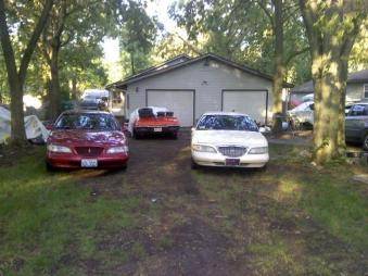

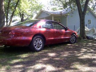

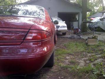

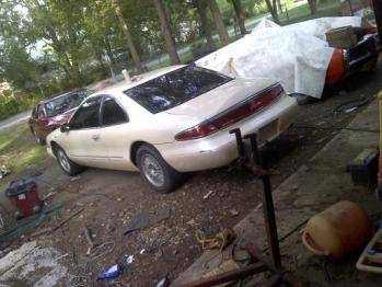

bought the white one... was the one in chesterton, IN on craigslist. is a base model, needs a decent amount of work, but was well worth 600 bucks.. threw a couple pics of the lsc in there too, more pics to come as progress comes along. white car came from texas too, is in wayyyyy better shape body wise then my lsc, shes getting cancer :( getting fixed this winter though :)
