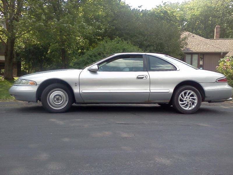

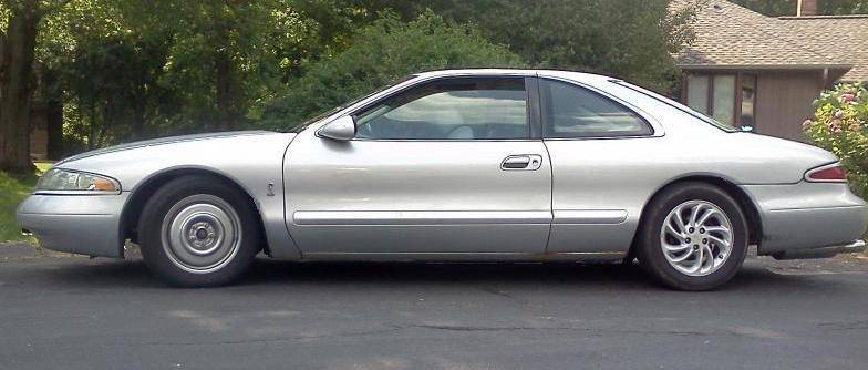

Honestly, I really have no idea on the LX vs. SC springs but I can't imagine the car would sit any higher! LOL

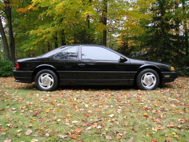

For what it's worth, I saw pictures of a 90 Tbird SC on stock suspension and my car sits at about the same height.
for what it's worth, i saw pictures of a 90 tbird sc on stock suspension and my car sits at about the same height.
That is pretty high :p. Since I've never done this before, I wouldn't know what to do about that. Definitely would want it a bit lower.
