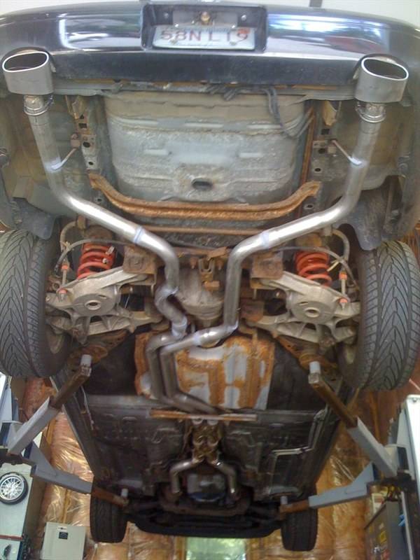

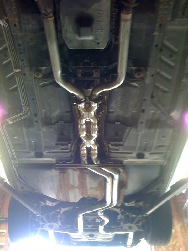

not to ressurect a very old thread, but this is mine with $24 xpipes from ebay and installed 2.5" piping from front cats back all for $250
I have been noticing no one likes to go and peice there xhaust system togeather. Or deal with the Mustang pipes. They would rather buy one kit that they know will work with no problems. . .
I chose each piece of mine the mufflers, the X and the tips and what size i wanted paid big money for what i had always heard was the best in the state no joke awesome work 4 pipes total one for each cat to the X and one each side to the mufflers welds ground smooth extra hangers so the system is totally stationary does not move and the tips measured exact distance out when i have the dumps put on will go back to them
