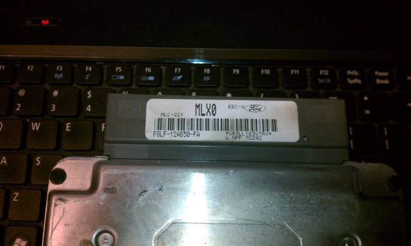

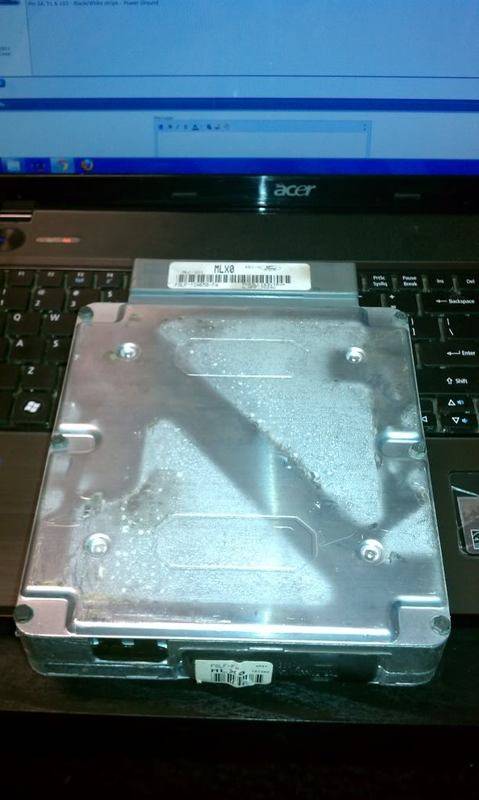

Alright,Thanks everybody! I am going now to check the earths/power supplies.(thanks Andy the link has got some good leads for me to follow)and I think the computer must be powering up because it powers my scan tool.There is no battery in it.Or is that power supply on the plug come from some thing different?I also am trying to make sure a base model eec will work (even temporary)on the LSC??Anyone ever tried or know if it will work.A junk yard about an hour away has a LSC computer.They say there is no interchange between the two that they think would work.I can get the 98 base from ZMT cheaper but I'm afraid to wait for his to come and it not work on my model. Im broke right now because of the DENTIST!!Thanks I hate to keep dragging this post outguys,but I'm really stuck!!

here is the catch code off the one i pulled today for you.
