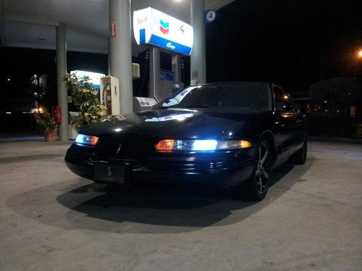

& here's a picture that has nothing to do with the issue... Just fueling her up last night & took a couple pics.

AND YES SICK.. SIR
