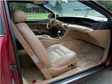

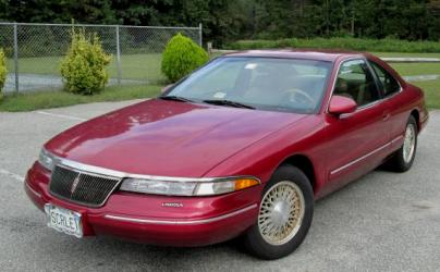

1994 78k miles Garnet Red Glaze Prairie Tan; on air slight pull to right when braking; decent rubber; body vgc with clear coat peel on top; grill in Ec; headlights factory replacements 2-3 years old in EC; drv seat moderate wear on leather; int in vgc; no cel; 2nd owner bought in 96; southern car; $1800
At that price/condition/mileage, you better buy Contestant #2 before someone else does.
