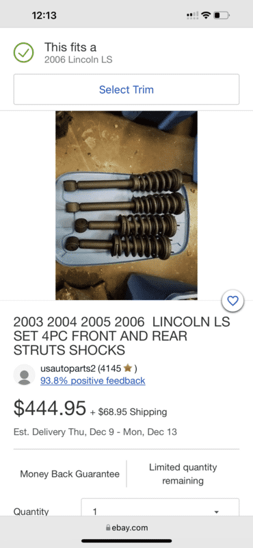

I’ll be happy with anything, where can I find these KYBs
No... there were never any "loaded" shocks (what most people call struts). Never sold that way from a parts store... or dealer.
It was mentioned above (somewhere) that they didn't come that way.
I also already said above somewhere... that the springs would have to be installed by a shop.
