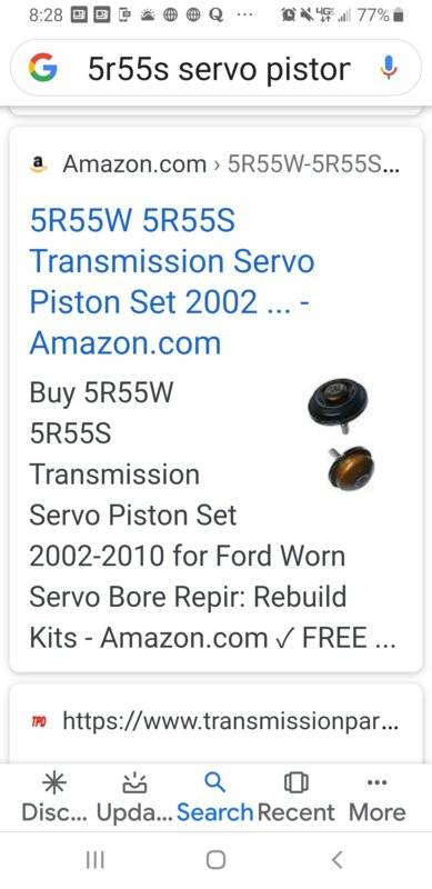

Check to see if the servo pistons need attention.

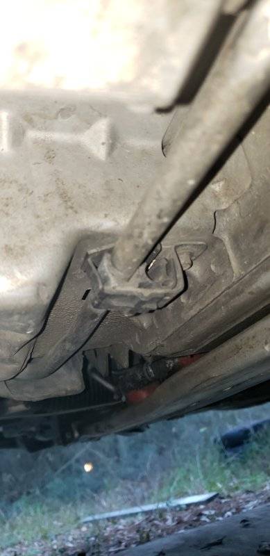

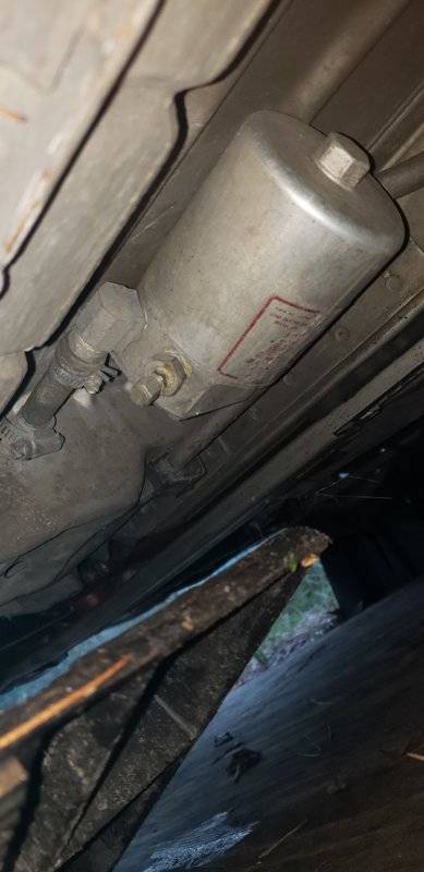

Here is photo of the installed filter assembly with the Shrader valve. Added a photo of the filter for this assembly. I got tired of removing the front tire to replace the fuel filter and for boot added the valve with 3/8 Aeroquip hose. Good luck
