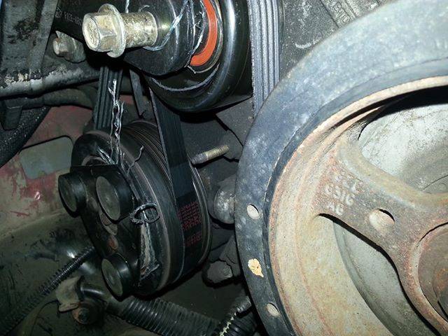

This is on the blown8. The other day it shredded the belt on the highway when I matted it and burped out over 2 gallons of coolant. That was fun. :mad: So anyhow, I bought a new GATES belt for the car and put it on with the help of a buddy and a PDF file that I pulled up on my phone for belt routing.

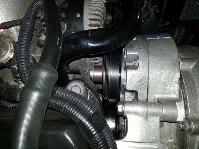

Here's an interesting fact. For whatever reason, the supercharger pulley on the back of the head unit had some gouges in it with some burrs. I really didn't think it would have been an issue but now that the new belt is cutting like this is it safe to assume that the bad spots on that pulley are the culprit?

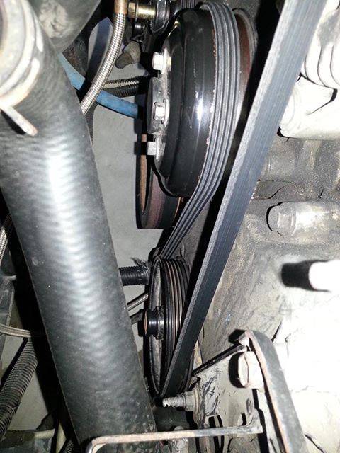

NOTE: The signs of belt cutting can be seen in the picture with the tensioner/ac pulley and oddly enough that is right below the supercharger pulley that is nicked in the grooves with some burrs.
that belt walked. its not on the same grooves it started on. when it moves like that it cuts off the rib that fell off.
gotta figure out why its moving on you.
the third pic shows its the front ribs being cut off, you see the scuffs. its walking forward on you.

Welp, I see what you are saying. I don't know why the hell it is walking forward unless we didn't have the belt on properly but I sure thought we did. When we put the Gates belt on I spot checked the wp, ps, and alt pulley and they were all moving freely. The factory tensioner seemed fine and the SC pulley seemed to spin like it should. The only one I didn't check was the secondary tensioner that is on the supercharger but that thing is pancaked in there and impossible to get to for checking free play although I wouldn't think any of these pulleys binding up would cause the belt to walk. That seems to be a misalignment issue more than anything. And I don't know why anything would be misaligned either unless a pulley is falling off of the car. Everything looked fine to me other than the nicks in the SC pulley. *SIGH* So yeah, I am having a WTF moment at this point. I'd actually like to get it fixed so I can put it in storage again. I'm easily annoyed and just feel like parking it again.

Show a nice pic of the complete IAC tube. Check the Vortech idler pulley under the blower pulley. The older brackets break there all the time, ask the guy with the mint blown cream Gen2. Also would not hurt to knock down and deburr the blower pulley.

one of three things cause that... Errrr 4 if it was user error.
1. You have a collapsed bearing on one of the pulleys
2. Miss-aligned supercharger bracket/charger in the bracket.
3. Main tensioner is going bad, if this is the case you rev the car and when the pelt pulls the tensioner you will see it twist.
These are the fact Stromberg, not my opinion.. However that is what a forum is for; the people you are insulting are just trying to help you.
