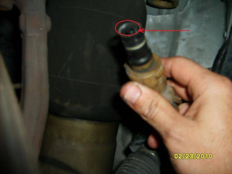

I have been taking LaserSVT's advice on looking at my front bag deflation problem and still is an issue. I took the solenoids out just now from the front bags, I replaced the D/S o-rings, then went to the P/S and when Ipulled the solenoid out, it is missing the tip that pushes in and out, one of the o-rings was stretched and half off, probably from when I pulled it out. But with that cap missing, could this be my problem. I am thinking that the cap is in someway a check valve with it being able to open and close, correct me if I am wrong, here are the pics of the P/S solenoid.
That cap holds on a second o-ring. That is more then likely the issue with the leak. Need to replace that solinoid.
When you said cap in a PM I thought you were talking about that little orange ring where the line goes in.
The cap on the D/S solenoid when I took it out slide up and down being locked in by the fork tabs, the 2 o-rings are below that cap with a teflon spacer between the two o-rings on the solenoid shaft, you have to roll the o-rings over that said cap. And further more, how in the hell did it disappear. The solenoid would have to be out to get the cap off?
That cap isnt supposed to move. You may need two.
As for the cap missing, someone pulled it apart at some point it seems.
Bill, the cap if you look at one of your spare ones is a slider with the air supply port in the center under the cap, that is why I am saying I think that it is a check valve, when the air pressure is at spec, it applies pressure to the cap to close off, then when it starts to pump air into the bag, it forces the cap up to allow air in, then when the air stops pumping into the bag, the cap is forced down to close it off. That is the way I see it, I maybe wrong, but mechanically that is the only way I see the purpose of it.
Yeah, i have two in my hands. Both do not have moving caps.
Long ago when I was trying to diagnose a suspension problem, I took a spare solenoid and cut that whole top off of a front sensor with a razor blade and stuck it in one of the rear bags. It has nothing to do witht the sealing or operation of the bag. The rings that seal the bag are the 2 that are stacked with the spacer in between them. That top part may still be stuck in the bag, and it only holds a small filter to keep debris out of the solenoid's moving parts.
this was always my understanding.
Well, I went ahead and replaced all the o-rings on the solenoids, and reinstalled them. The only one that did not have that cap was the front P/S. I will see if the o-rings work, and if not and the front still deflates in the morning, then I will take a change of clothes with me to work and when I get off, stop by the JY and pick up 4 solenoids and swap one at a time till I find the culprit. If this is even the problem. Like I mentioned earlier, the car only has 67k in miles and the air ride is in excellent shape for a low mileage one. Just keep at it and eventually I will find the problem I guess, process of elimination of sorts.
First thing I thought of and I took the shop light and looked up in there and nothing in the port. SO either the cap was taken off by previous owner or shop and never put back on. Put I did replace all the o-rings on both front solenoids and left the teflon spacer in there to space them. I will see in the morning when I go to work. Always in the garage and I have tried to sit in the garage for up to 5-6 hours watching a few DVD to hear and watch it deflate but never deflated so it only happens after 8-10 hrs of being parked.
Cap in red circle is not supposed to move.
That is a different solenoid than that of mine in the picture. The black shaft where the o-rings are is shorter in length than mine, that might be a aftermarket or TC or Continental or rear solenoid, do not know Bill. But definitely different than my front 2. You can tell the difference in the 2 pics I posted earlier.
mine look like this.
with the cap and "marshmallow" filter underneath.
That is what mine look like too, the cap is held in with the fork prongs and slides up and down with your finger or thumb easily and the only way to get it off is to depress the prongs inward.
that cap is not critical to holding air. i lost one of mine months ago and the front hasn't leaked down yet.
